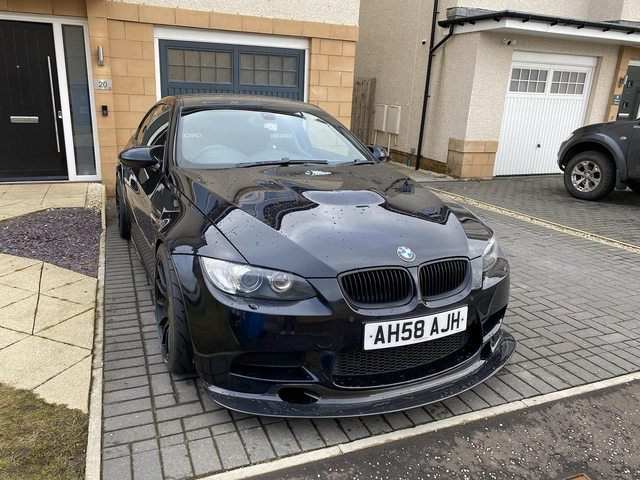

So the above is the first picture of the car in its complete standard form and will be the last, lol.

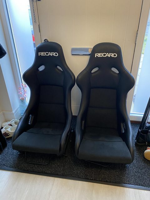

I ordered a set of Recaro Pole Positions and PCI frames and rails to go in which arrived yesterday, I went ahead and fitted this last night which wasn't as straight forward as I thought it would be, the seatbelt receptacle wasn't fitting correctly, pushing against the transmission tunnel not allowing the frames to line up with the bolt holes in the floor. I did have plans to keep the original belts given it was a daily driver (for now) but chances are I'm gonna ditch the original belts.
It was like Christmas all over again when these arrived.
and finally fitted..

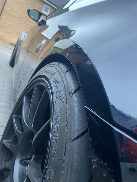

The protrack wheels also turned up, much much earlier than I thought, got the tyres fitted and stuck them on. These are 18x10 square. 5mm spacer required up front and likely will run a 10. Had to run a 10mm on the rear as my nuts were too long, I have a Millway stud kit coming but chances are I’ll still run the 10mm on the rear until I get 11s for the rear
Still need to get some spacers as I’ve borrowed some just now, unsure which brand to buy
without the spacer

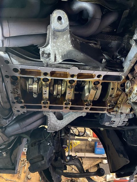

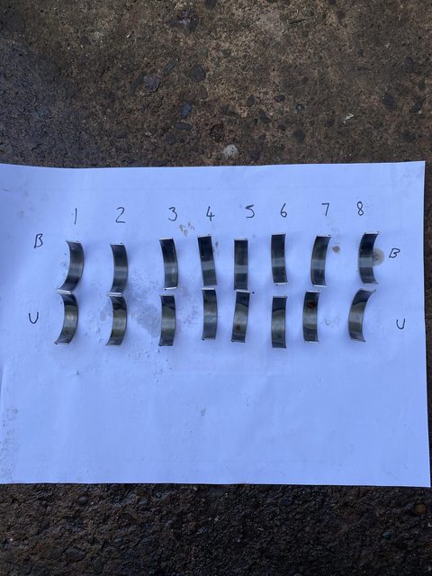

Got the car on my mate's ramp so he could tackle the rod shells. The didn't look too good but nothing catastrophic. Replaced these with ACL and ARP parts. Additionally fitted new competition Vibratechnics engine mounts and to be honest, you would never know they were changed, there is no increase to NVH. I got the Tegiwa decats fitted and honestly wow the noise of the car has been transformed. The BBK is also on!

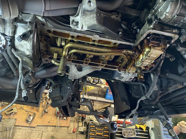

Within a couple of hours, we had the subframe off and sump down. There was a lot of carbon build up so we got the sump all cleaned up using a parts washer.

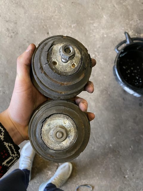

Got the old engine mounts out, they were pretty ******.
Next up was getting the bottom of the rod off to get the shells out and back up.
Old shells

Next up was to fix the camber. The garage which done the alignment couldn't get more than 2.5 degrees of camber as the top mount nuts couldn't be tightened if pushed right over. In order to solve this i jacked both sides of the car up and pushed the strut in towards the car, this allowed for -3.5 degrees each side.
As a result of running the 18x10 Protracks with 12mm spacers, the wheel is rubbing of the arch liner. Not particularly sure how I'm going to proceed with this yet
