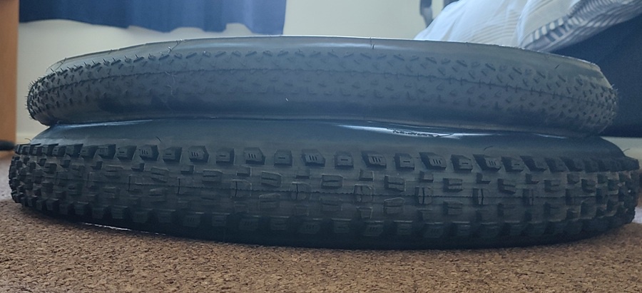

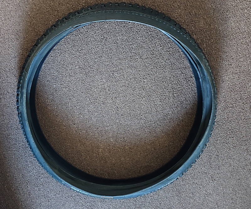

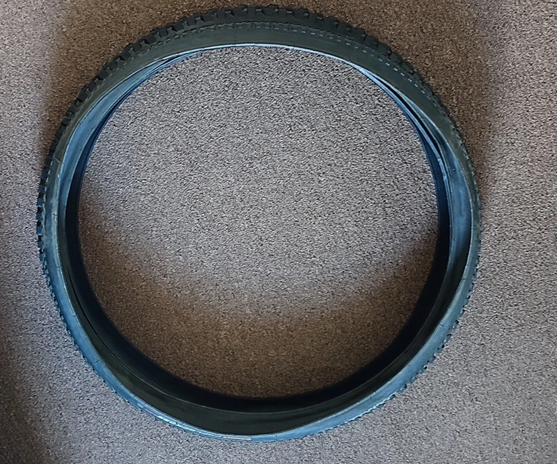

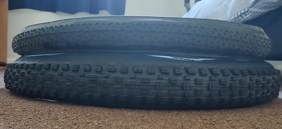

700x 35 gravel bike tyre(also same tyres hybrids use) vs MTB 29x2.5inchI think the actual rim of a 700c tyre is actually the same as a 29" mtb bike (622mm) but the extra size generally comes from increased tyre size.
