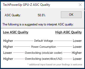

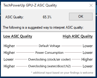

Seems like a load of BS to me. Both my cards have pretty low ASIC Quality but they overclock like bats out of hell, also not needs tonnes of volts.
In my experience lower is better for overclocking. Since it seems higher is better for other people, i guess its no indication of the overclock potential.
