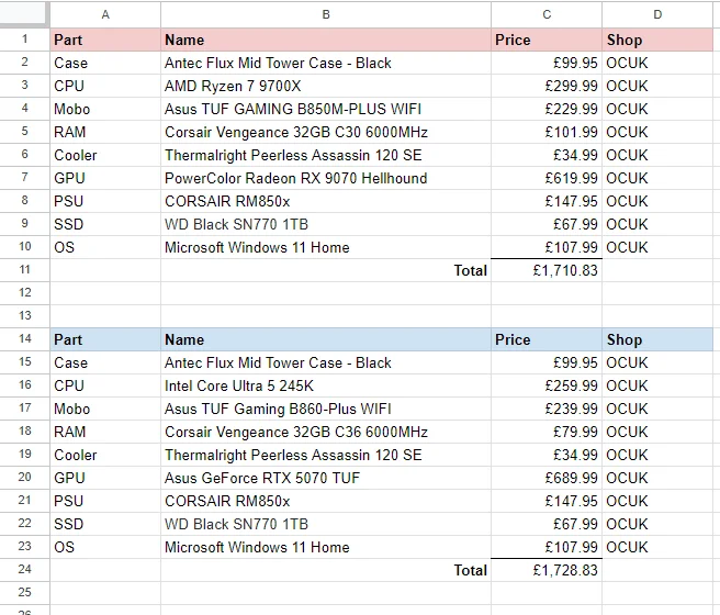

I got a bit further along, in that now that I have some options priced up just to see what's doable in budget (£2k ish). GPUs are a bit of a problem, either out of stock or overpriced, so I'm in no rush to order (maybe in 1-3 months). But getting to this stage means I can post it and you can suggest stuff, so here it is:
To explain not choosing X3D - gaming is one of my requirements but I don't game a lot so I don't want to pay a premium for it (GPUs already feel borderline not worth it). I play at 1440p, high settings is fine (ultra not needed), not fussed about ray tracing, 100fps is fine. Generally not playing AAA games / unoptimized console ports etc.
honestly no point discussing specific pricing now if you're not going to order now.
if just gaming and web browsing, don't really need a 9700x, i would go for either a 7600/9600/9600x or a 7800x3d/9800x3d
if dropping down to a 7600/9600, would be able to fit a 9070xt into budget, which for gaming, a 7600+9070xt would obviously be a better combo
also £68 for a 1tb ssd is also madness - especially the sn770 since it's nothing special (tlc, no dram cache). i'd just pony up the extra for a 2tb team mp44l, that's available for £100
lastly, £108 for win 11 is madness. there's other ways to get it cheaper
The 9600 non-X hasn't been reviewed widely yet, but I'd take a look if you can find one, because the non-X CPUs typically run cooler and use less power. Though, the 9700X/9600X aren't bad on that front anyway, so maybe it won't be true for them.
I wouldn't want to pay that much for a motherboard, for either the 245K or the 9700X. Their power use is very low, so there's just no need for a high-end board. The £150 region is where I'd be looking. PCIE 5.0 is nice, but it is getting turned off a lot lately to avoid issues anyway. If a cut in the motherboard meant you could afford a 9070 XT or 5070 Ti instead, for example, I'd get the cheap board every time. The only time I would not, is if I had plans to run the CPU at very high load for extended periods.
5070 for £700? Lol. Get out of town. Anyhow, when you order in however long the market might be completely different by then anyway.
The build in my sig cost me £2000 not including peripherals. The 4080 super is end of life so a 5070ti would be a great replacement but would recommend the 7800xd3d over a 245k for gaming as the new intel core ultra chips are great for productivity but not very good for gaming and besides the 7800x3d is a power house for gaming :). If you know how to undervolt, you could get this system to use less than 500W even lower than 450W at full load.
