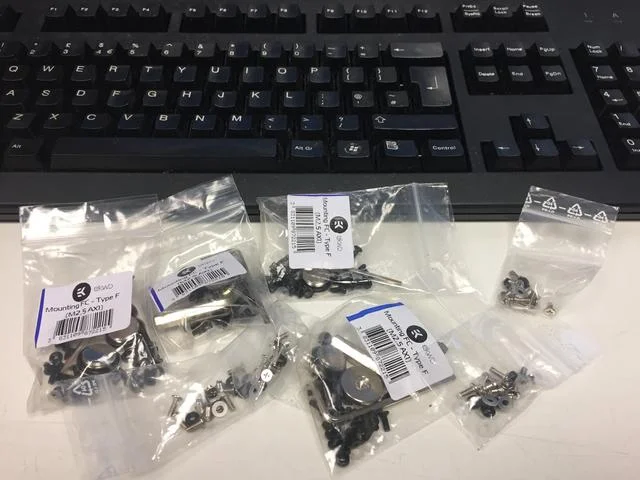

I suppose I should include what it is that I have an issue with and its the 980ti wf3 waterblock and backplate.
They mention m3 screws for the waterblock when its m2.5. Then on the backplate kit they say m2.5x6 and provide me with m3's which don't even fit through the holes on the backplate! On top of that 6mm is not long enough anyway so its all over the place.
Instructions are not difficult. They are just plain wrong.lol
They mention m3 screws for the waterblock when its m2.5 (m2.5 screws provided so no biggy). Then on the backplate kit they say m2.5x6 and provide me with m3's which don't even fit through the holes on the backplate! On top of that 6mm is not long enough anyway so its all over the place.
Ignore thread length. Its thread diameter that is the main issue with the backplates not fitting. Atleast with the parts I got. Plus the fact that the only sizes you are left with out of all the screws you get are too short to go through backplate, card and block..
The two longer screws are required at the opposite end of the plate. Which is irrelevant in my case as its either right length wrong diameter or right diameter wrong length.
Its not an issue for me anyway as I have some m2.5x10's that I used.
