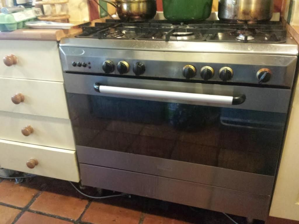

Engineer refusing to fix my cooker
No, we just don't want to be responsible for other peoples poor installations, the second you touch it, you take ownership of it.
Strange how they never refuse boiler install jobs, touching the old dodgy pipework takes ownership, right?
o like car mechanics fixing someone elses bad installation on my car?
O and no, i would have cleaned it. so dont come off as some almighty person as you do not know me or my intentions.
I am use to cleaning the worktop area before an engineer comes because shocking truth, one of my close mates is an engineer.
He also said that a gas/cooker engineer SHOULD bloody raise the oven/cooker and do whatever is needed to make sure its safe and bill me. Simple as that.
I myself SHOULD NOT TAMPER with the cooker in any shape or form!

Now I'm not a gas installation wizard but how could it not be connected with a flexible hose. How would you connect it with solid pipe once it's in place. I haven't had a gas oven in years but I have never seen one that wasn't connected with a decent length flexible hose and then pushed back into position.

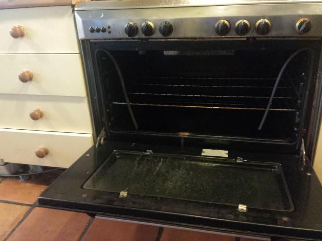

The oven isnt the worst Ive seen, its not looking great but its not really the point.
The fact that you have kept it that low for 10 years while scorching your worksurface is a bit crazy, but anyway..
Edge the cooker out towards you, looking down the back you will see the flexi hose should have lots of play on it, unless for some crazy reason the gas pipe is in the back of an adjacent cupboard and the pipe is routed through the unit.
Once you confirm this, you are perfectly safe to lift it up. Cut 2 Lengths of wood the depth of the cooker (and as thick as worktop) so its long enough to fit under the front and rear legs.
Lift cooker and slide these planks under both sides.
It might now be slightly high, but the legs will no down screw down to lower it.
Job done.
Manky oven. But after lifting it, it sounds like you need some metal edging on the worktop to prevent scorching too.

regardless of height anyone can refuse work if they aren't willing to get covered in dirt and fat changing out a thermocouple..
