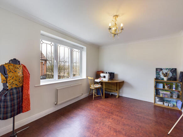

I personly think I will go with LVT, we have it now in a 20 year old house, I assume it is the original floor as it is fitted throughout the downstairs apart from kitchen and lounge. and its still in good shape, apart from being a bit green next to the large patio door and the 2 side windows next to the front door.
If it wasn't in a god awful orangy brown wood effect I would be leaving it down to be honest.
NOTE: not our furniture
