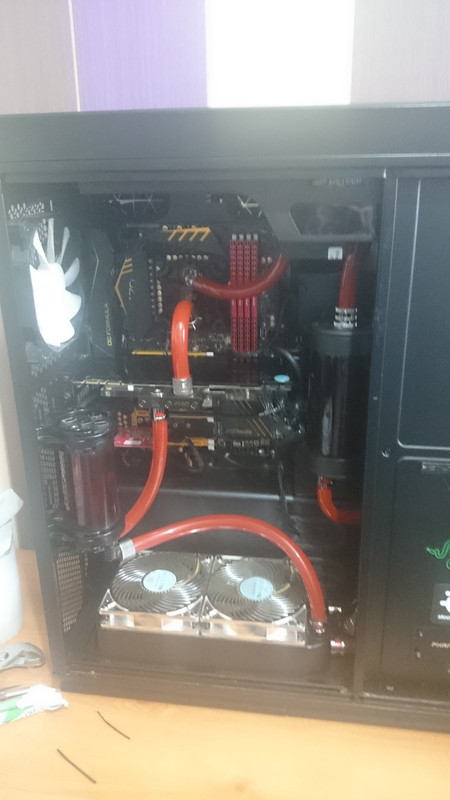

Found some photos of the 719
Totally forgot I actually fitted a 480mm rad on the front
360mm on top with built in pump and res
And 240mm on the bottom
And an ek xres and d5 second pump
Though was a very tight fit with the 480mm

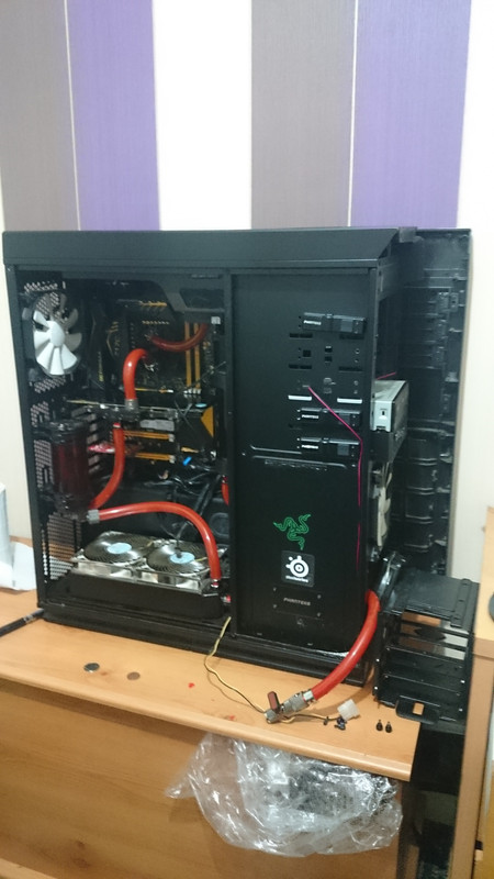

actually found some
cant believe was around 9 years ago
the photos arent much help anyway
terrible phone camera back then plus the drive bay
support bar/brace totally blocks the view
of the front radiator
i was slightly wrong
didnt attach the castors directly to the primo
used the castors and a floating shelf i had laying around
and made a little trolley or however would be called
so i could move the case around
as you know full of watercooling gear
the things severely heavy
