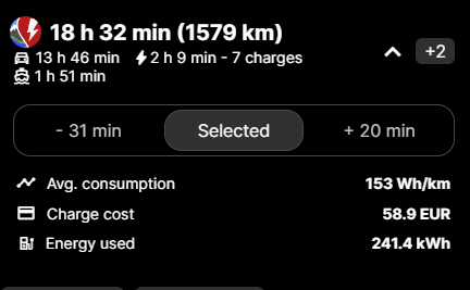

It literally tells you on ABRP the cost based on the car you select, why are you even guessing with zero experience of using an EV?

abrp does not know the price of gas/kwh - it's giving bs.
e: yes - would be wonderful if you could travel to South of France for £50
No you are taking rubbish (again).
It shows you 241kWh needed, and it knows which stops you are stopping at, since it planned the route for you, and knows the cost of the chargers on that route per kWh. So €58.9 is correct, but I guess you know better being the expert on all things EV.

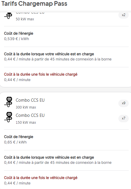

I was using a public charger for costing ... and I'd used the cheap electricity
e: those 241kwh cost 156e , 132e for fast slow.
Again proving you have zero knowledge of BEV charging. If you are in France/Europe you'd pay €0.33 per kWh at Ionity with a €7.99 subscription, and all those are fast 350kW stations are there are thousands of connectors. Why do you bother to comment here, you have over 1,300 posts in a thread with no factual knowledge of any of it?

In terms of EV vs ICE sums, ABRP is a good tool, it’s a bit conservative, better to err on the side of caution I guess.
