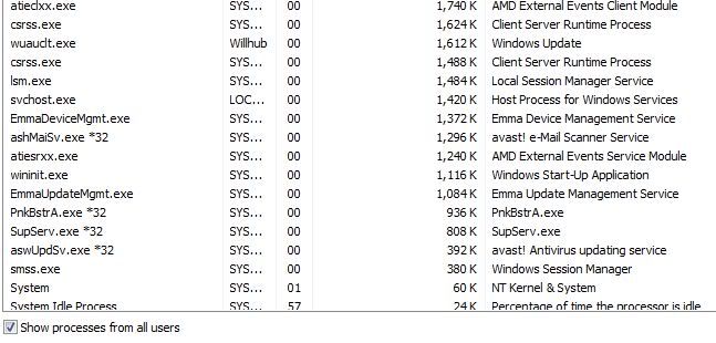

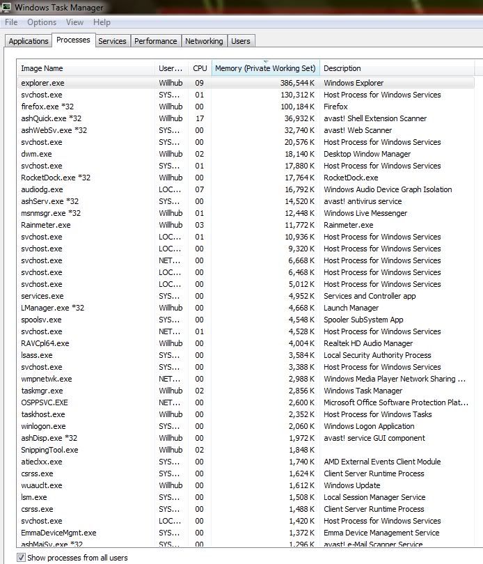

Here are complete pics of them.
Currently explorer.exe is at 505mb and creaping.

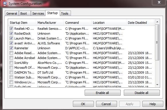

Try rebooting with only Avast started in msconfig.
Also check addons in Internet Explorer (if you use it). If it's not a start up app, then I think it's a virus.
I'll post one up later, weird thing is, at the moment explorer.exe is fine, I remember though, at the time this memory creeping started, explorer crashed, so I closed it, restarted it and it started creeping up, I just restarted it now to see if anything would happen and explorer.exe was stable at 24mb.
No codec packs, Rocket Dock is a dock full of shortcuts I use, it's very popuar, I know this is not the cause since it's on my desktop also and the desktop does not have the problem with explorer.exe

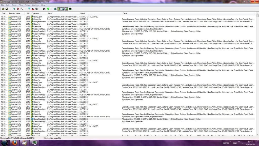

How do you use this procmon app so you can see currently running processes and the process tree?
**edit**
Maybe I've sorted it?
Too many entries to get on the screen though..
