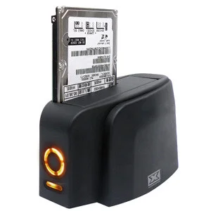

ive seen 2 different styles.. where hard disk just slots in like an sd card or the normal in a box with a fan style.. any pros or cons to these? obv the drop slot one would be useful if i wanted to use more than one hdd, it would also save money as i could buy 1.5tbs which are at a much better price point than the 2tbs

by dock i mean something like this
