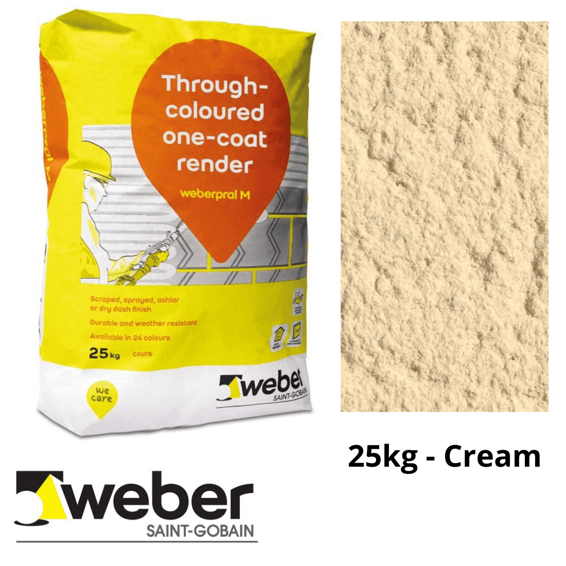

You can get a one coat render that goes over the dash if it is sound. You could also go external wall insulation over the dash if you have a solid wall, once again depending on soundness and level.

This, you'll never get pebble dash off without a lot of time and pain. Colour through render over the top and job done.
With ours it didnt add much thickness so there wasnt a huge step to next doors origional pebbledash.

That's banging. I didn't realise you could do that!
I guess this is just a cosmetic thing though?

Yes. It was to tie the extension in as we didnt want to pebble dash the extension. The entire rear is rendered to as it covers a mix of old and new walls and just would have looked a mess otherwise.
I will add its not cheap stuff though! was about £15 a bag which does 1m2 I think if my memory serves me correct! Fortunatley the brother in law is a plasterer / tiller so he did it and also had 10 odd bags left from a previous job so the colour was kind of picked for us!
