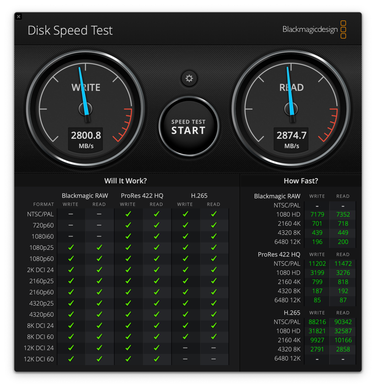

Mine is out of sight and it got a bit warm so I heatsinked it. Have a shufti here.
There are often special prices on the nvme, I paid around £130 for mine and another £120 or so on the enclosure which is a little above your budget in total but it's well worth it. You have to have a 40Gbps enclosure or you're never going to get above 950 Mbps transfer rate.
