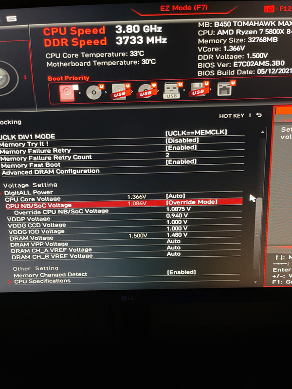

I have 4x8gb running fine in my b450 tomahawk max, try running my settings for SOC, VDDP, VDDG CCD + IOD voltages, don't try my settings on the Dram voltage though.
