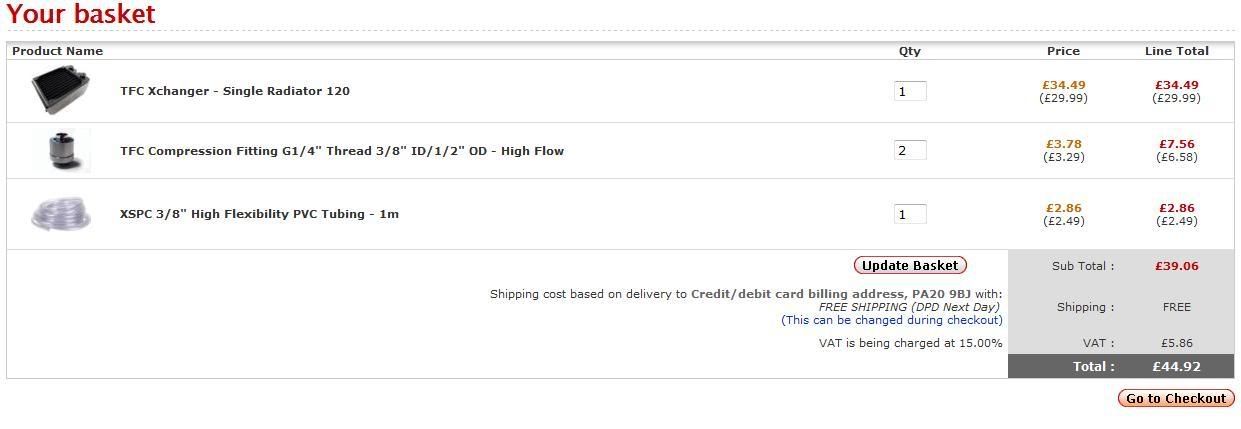

So ive decided to add a 120.1 rad to the loop and make use of the rear case fan that is already running to help reduce my temps whilst still enjoying the silence i currently have.
To this end i have put together a shopping list and am just looking for a couple of opinions as to the merit of its current content.

ive decided to purchase the D-Tek fusion block from MM will see if that helps reduce the temps slightly.
if i can get enough of a temp drop i might retry OC this system to get a bit more life out of it giving me more time to save up for the full upgrade later this year.
