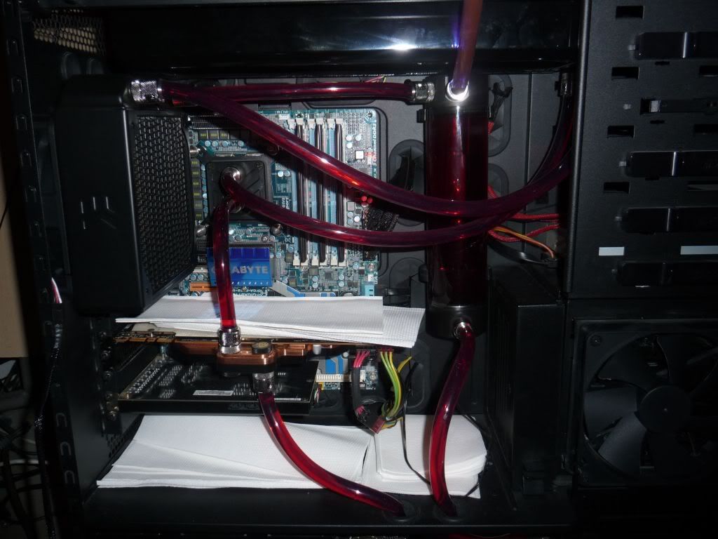

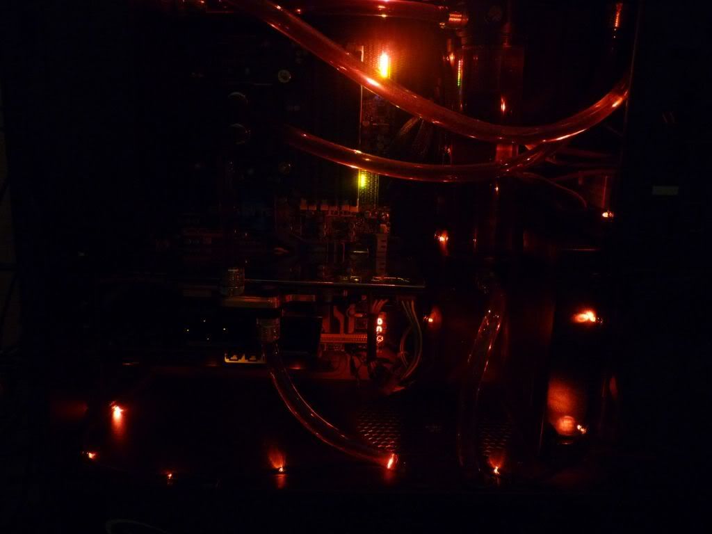

Got the Radiator installed today and I have to say I'm mighty happy with the result...
Although taking apart the loop to fit it in, change the tubing, was a serious pain in the ass... I had to change the orientation of the 360 rad to accommodate the new 140 and mounting that thing in a pull config is not fun... In the end I went with the following config:
Res > Pump > GPU > CPU > 360 > 140 > Res
Here are some quick pics of the final setup, will clean up the case some more tomorrow and take some better pics to put in the watercooling case gallery :)
