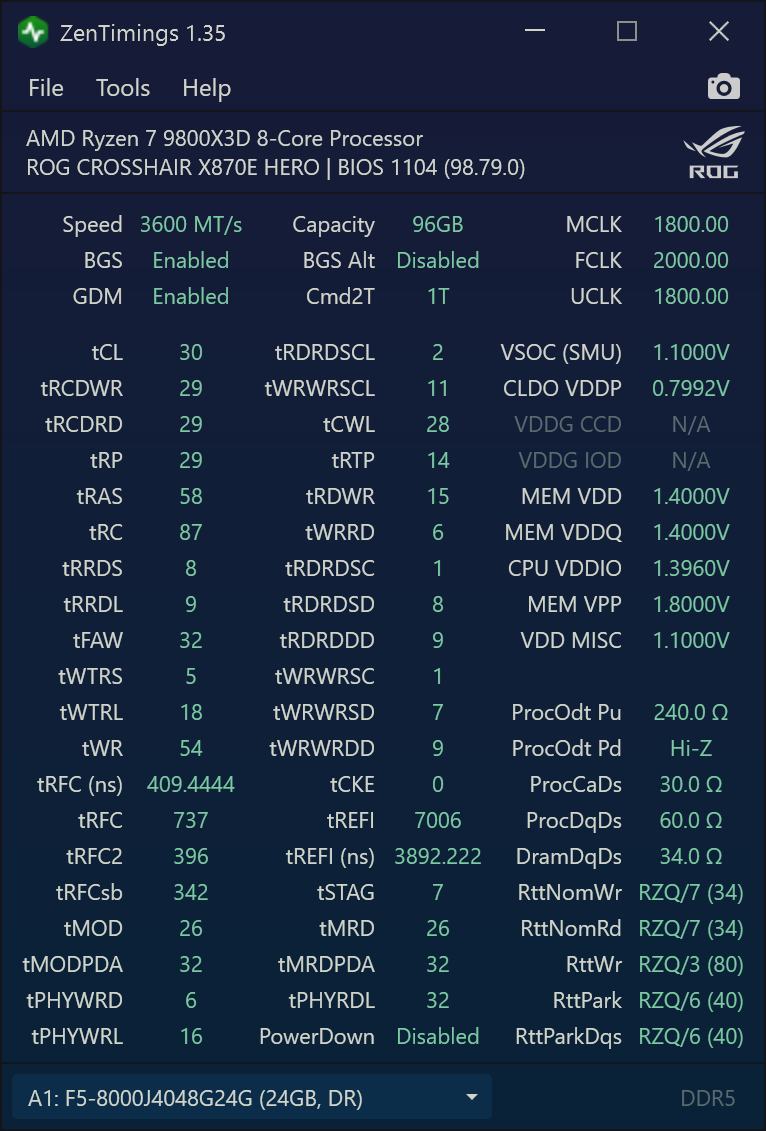

For reference this is the only speed and timings I can get into windows (10 with all the latest updates) with:

I tried manually typing all the timing values from the EXPO profile and some of them (tRAS 128, tWR 12) error out with "invalid input range". Setting tRAS to 126 and tWR to 54 I can now boot with 4000! Is this a bug in the BIOS / EXPO profile? why does it use invalid values? who should I report this to? Gonna try higher speeds and will update on success / fail.

Indeed changing tRAS and tWR seems to have somewhat fixed the issue, I can now run at 5600 without crashing. Gonna try pushing further. Still, I'm not sure whether to contact ASUS or G.SKILL as they collaborate on the QVL and supported profiles but clearly the values on the profile are out of range / broken.
