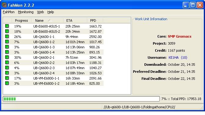

Just upgraded all my boxes to the latest Linux SMP client, added 3 more clients to each Quad and 1 more to my E6800. I find it hard to belive that it will bring my PPD to roughly 18K. I was bringing in about 10.5 to 11K PPD.
Also, it looks like I need to pump up the volume on my first Quad box, as it's not performing as well as the second.
Does this Seem Right?

There's definately a difference in PPD when changing the calculation frequency on FaHMon:
Ignore Asynchronous Clocks = Not Selected
Prefrences {All Frames} = 17,975 ppd
Prefrences {Last Frame Only} = 17,250 ppd
Prefrences {Last 3 Frames} = 12,950 ppd
Ignore Asynchronous Clocks = Selected
Prefrences {All Frames} = 9,628 ppd
Prefrences {Last Frame Only} = 17,774 ppd
Prefrences {Last 3 Frames} = 12,952 ppd
Basically, it's inconclusive. Both methods show similar results in {Last Frame Only} and {Last three Frames}, with Synchronous and Asynchronous skewing the data in extreme's both ways.
I will know soon enough, as all the first WU's are nearing their completions Times
Next 6 Hours: 6400
Next 12 Hours: 5807
Next 18 Hours: 4430
Tota in 18 Hours = 16,637
Not to Bad for 1.125 days, but it does suggest that the 24 hour ppd is closer to 12K to 13K v.s. the 18K, which begs the question why would one want to run 4x clients v.s. 1x.
I suppose, that if your a Beta WU Tester or have concerns over EUE's due to OC (would not apply to network issues obviously) then the risk is lower going with 4x clients, as you would only loose produciton on one WU (hopefully) in an EUE or Beta WU malfunction situaiton, as opposed to loosing your entire production from a particular node when running only one client.

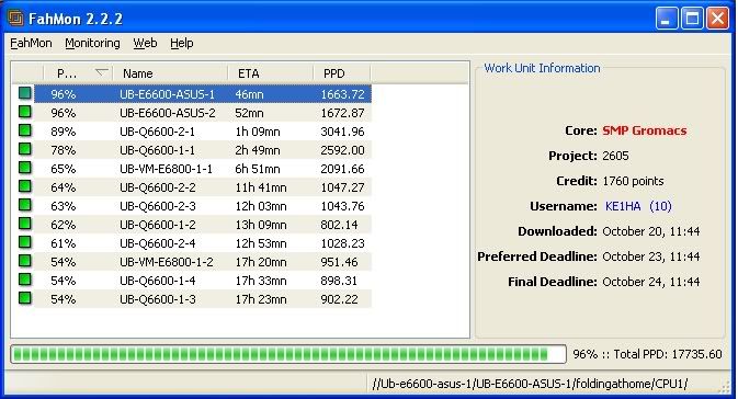

Here's the latest. I reinstalled everything yesterday. ASUS-1 & ASUS-2 are still running One Core Each.
