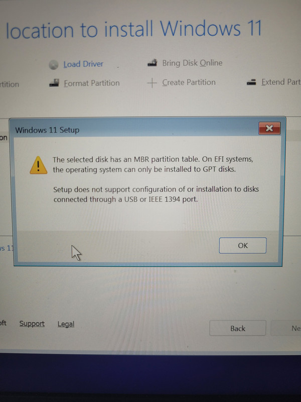

The installer cannot locate the SSD / HD in the laptop.
This could be down to something actually wrong with the drive / interface (if its detected in the bios then it won't be this)* or needing the Intel RST (storage controller) drivers to be able to detect the drive.
This is for HP but highlights the same issue: https://h30434.www3.hp.com/t5/Deskt...-showing-in-windows-installation/td-p/9012708
Been a while since I have encountered this but from memory you need the Intel RST Driver for your specific laptop (or dell series).
watch the above and try that - have literally just had to do the same to a laptop returned by one of our sales guys.

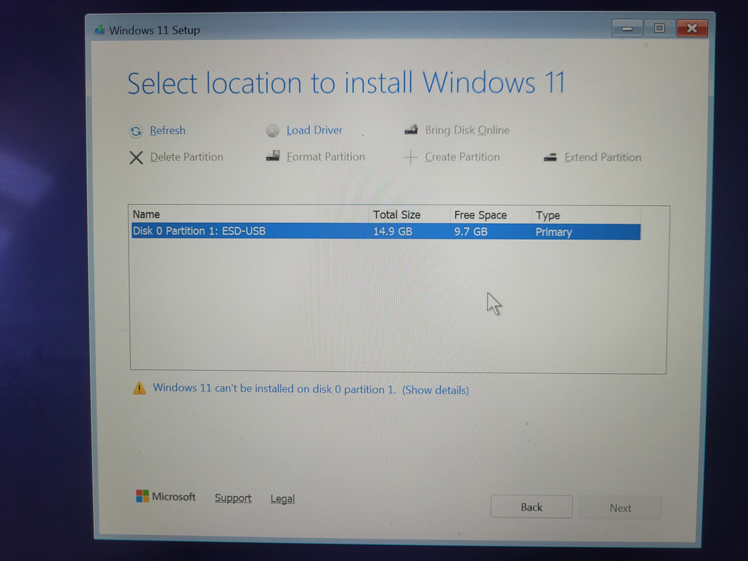

Thank you. Should i download the files from the HP thread or ignore completely? Searched on here https://www.dell.com/support/home/en-uk/drivers/driversdetails?driverid=7pgdm for Latitude 5420 and it says "Drive is not compatible"

Can you access the BIOS, by pressing f12 during the dell boot logo?
If so under storage, swap AHCI to RAID or vice versa.

I can. Swapped from RAID to AHCI and can see these now, but not sure what to do next as none of them allow me to select "Next'
Select each one (apart from ESD-USB) and delete partition until you are left with 1 big block of unallocated space and install windows 11 on that (The next button will become available).

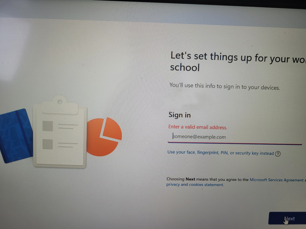

Thank you so much, that worked. However... i've gone through the reset and come to a page asking me to sign into a work or school account.
I can't use my personal email

The machine is registered in your company's MDM. I can't recall the name of the product (in tune?). You would now have to change so many components in it to bypass that it just wouldn't be worth it.
In effect you are stuck and depending on how diligently your IT administrators monitors these things they know someone is trying to reactivate one of their machines.
Nothing to worry about, I'm sure.

I don't think it could be done easily. It's usually the motherboard unique ID that is being used to identify the machine when it goes online. You can't really change that unless you had another (broken) 5420 laptop handy and swapped motherboards. Maybe your lcoal PC shop has one, it's worth a shot and should be less than £100
