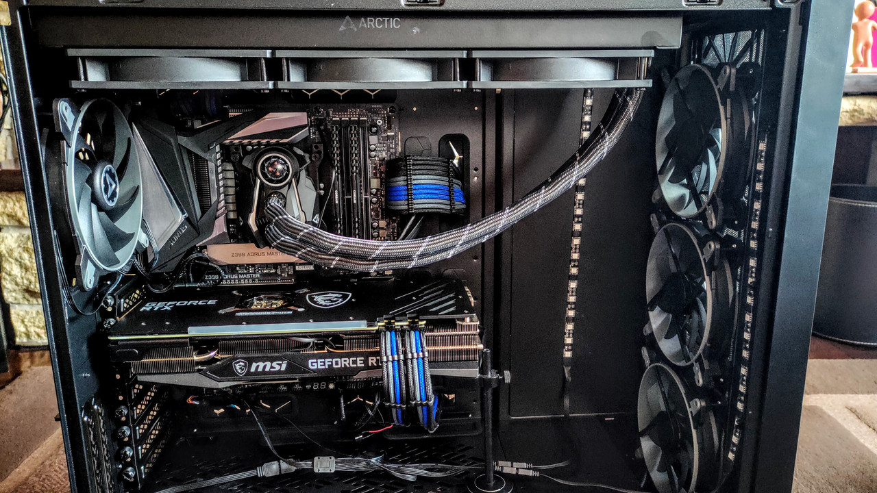

@Hostile_18 That looks better. The card seems a little "twisted" but probably isn't.
Well done.
For me....
can't really see the angle of the GPU support etc but it is needed for my long GPU card. I think that the power cables drag it down a little as well as the overall length of the card.

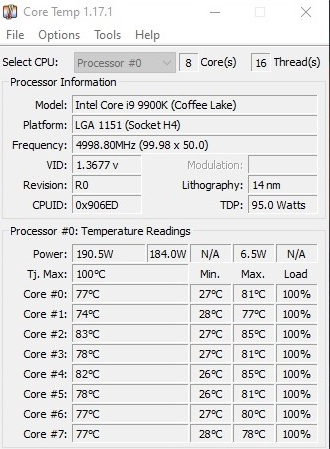

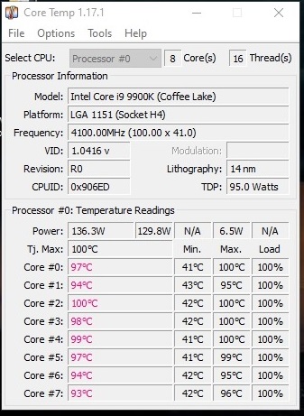

Very nice. What temps do you get with that?
Thanks
Here you go........
with the Noctua cooler it would throttle at a 5Ghz all core overclock with around 1.275v vCore.
Air....(so throttled and not always 5Ghz per core)
AIO.....(not throttled and always 5Ghz per core)
The GPU, probably other components as well, seems to be cooler with the heat venting out of the top of the case from the CPU rather than exhausting in the case.
The above is whilst running Cinebench. In more typical use the temps are cooler.
