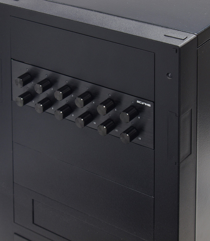

Another option would be using a fan controller that supports upto 12 fans, like the Scythe Kaze Q12.
