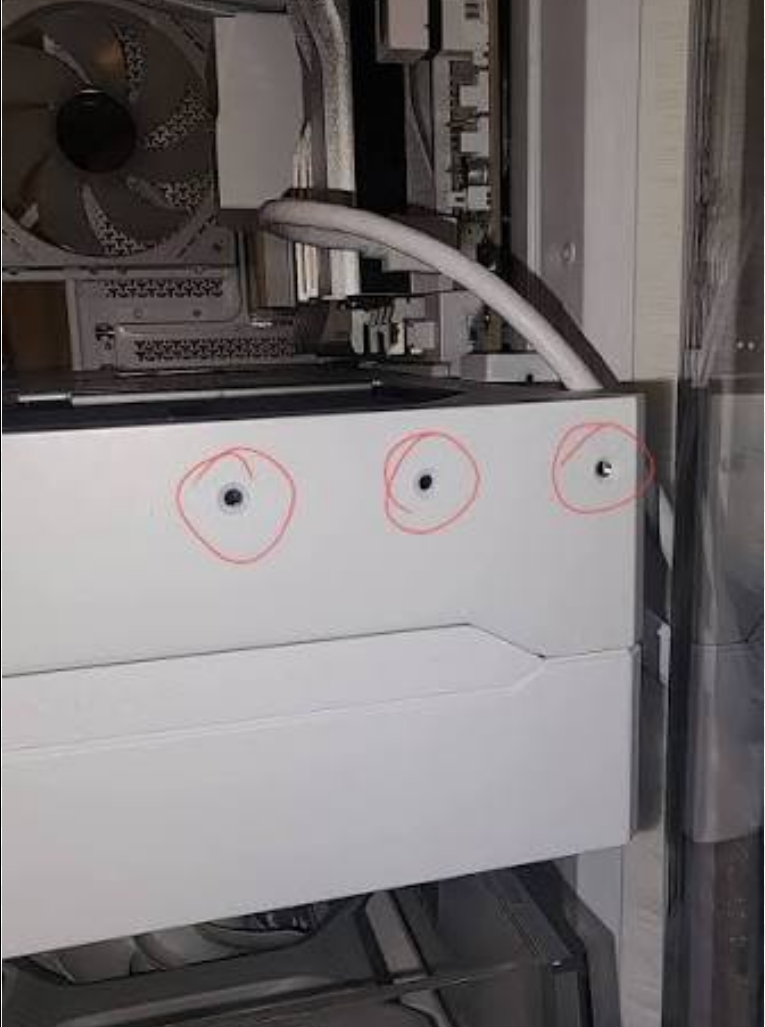

Looking for something very specific for my GPU, My GPU has 3 x screw in points at the end as most GPU's have, I'm wanting to get some type of mount to attach a small fan to blow cool air across the metal backplate.
Does anyone know if such a thing exists ? Any input is appreciated.
Example pic -
A metal fan mount with some minor modification would probably work as you may need to drill the holes to match the screw in points on the GPU (unless you got lucky). There are loads online so I'd just google the one that looks easiest to modify.
Would be pretty easy to just get something cut to size to make the mount too. Laser cut clear acrylic would look good and not stand out too much. With a smaller fan you could probably get away with just 2 fan mounting points and a small curved cut of to match the fan blades.
3D printing is an option too but I think clear accrylic would be better IMO.
Zalman used to do a fan bracket the BR123 that sounds like it would do what you want but I reckon it's discontinued by now. I bought one years ago and it was handy at the time. It shouldn't be too hard to make one out of sheet metal, plastic or even get something 3d printed, there's probably something already designed on one of the 3d printer libraries.
