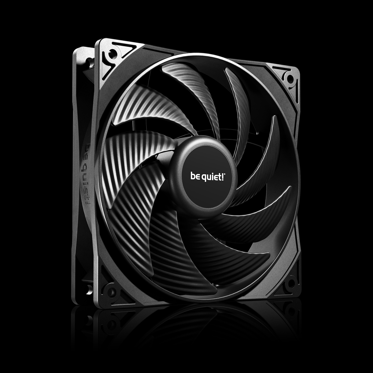

tbf at the price and in your case i think the Pure Wings are really good.
there just not for ITX systems, and if you look around they do 8cm models too.
I'm sure i paid about £25 a fan when they first came out. for a 10er there good
they have high speed models (so do noctua) but I don't want it too loud
Would be great if they was a high output single method, rather having lots of splitters, just to make cable management and clutter. ...oh they do exist but not cheap!
just keep an eye on the minimum fan speed, thats what you will use most of the time when the system is at idle.
have high RPM's in the bank for if you ever need them is good but if the minimum fan speed is somthing like 800rpm is never going to run truly silent.
on the be quiet site they say the 1600rpm model can spin down to 300rpm before stalling, thats a very good speed range
depending on how cheap you want to go the P12 and P12Max are stunning fans that move some air but over about 1000rpm there loud
i have p12's on my radiator at about 600 RPM and they do a good job
