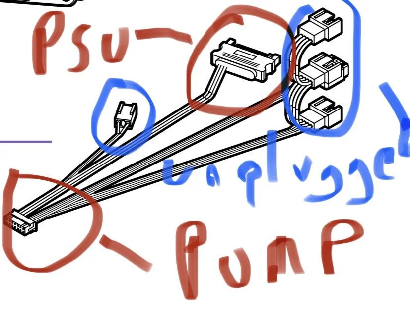

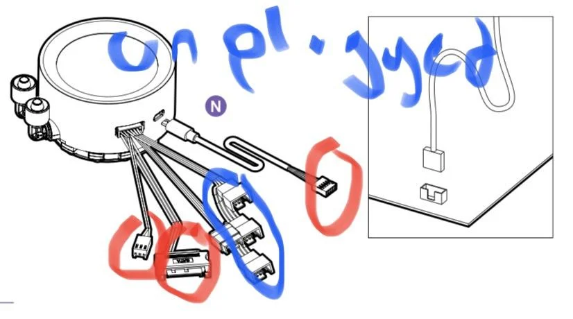

So I gather you have those cables shown blue below on some fans that are not connected to your radiator. I was planning on not having them plugged in at all but I didn’t want to give the pump a hernia! I could always add the three ‘come with the AIO’ fans to the back of the radiator, but to my simple mind it would be weird to have ‘non-identical’ fans either side. I guess it would be fine...
I suppose the only way to know if the below way of doing it would cause issues is to ask NZXT themselves, as everyone always seems to use those cables for something else.

In a nutshell, plug it all in apart from the 3 pwm fan connectors if you don't want to use them. ( use 2 of mine for case fans but could easily just connect them to the mobo instead) The sata powers it, the USB 2.0 controls it, the 3 pin is just the tacho / speed signal to the mobo.
Some older motherboards went into panic mode if they didn't detect any signal from the cpu fan headers unless the bios setting was disabled, imagine it may be something to do with that too?

If I leave the 3 pwm fan connectors disconnected (i.e. those circled blue as per the most recent image above) and plugged the 3 pin into the pump header, am I going to have to disable the CPU fan header in the bios to avoid a 'you have no CPU fans' error? Or it a case of seeing if there is an error and, if there is, make the change in the bios? Or was this only an issue with older motherboards (in which case it should just work fine)? I'll be using a 2020 board.

It may require disabling of monitoring in the bios, but I'd expect it'll most likely work fine as it's still using the CPU_Pump header (and I'd expect most boards these days will account for AIOs having passthrough control of fans). The blue plugs won't have any impact, they're just there for passthrough fan control via the AIO software.
