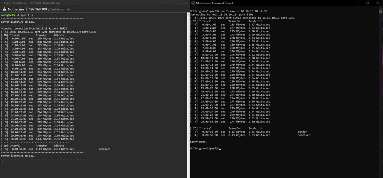

Oh and 6.8.3 onwards supports RTL8125 from what I read.
I've read that it does, that does but only at 1GbE, and that it doesn't and I need to wait for version 6.9 (no interest in running beta). Unraid is a great product but they really need to sort out their hardware compatibility information.

The problem with Realtek is they’re the soft modem of the NIC world, the drivers are closed source and they don’t use things like hardware offloading to make hitting stated numbers easy. For it to be perfectly fine I would expect IPerf to show maximum throughput consistently and not significantly increase CPU usage, that’s not happening.
Avalon's right, it doesn't hit the full 2.5Gb throughput, but still at 2.3Gb its good enough to saturate bandwidth from mechanical disks.
