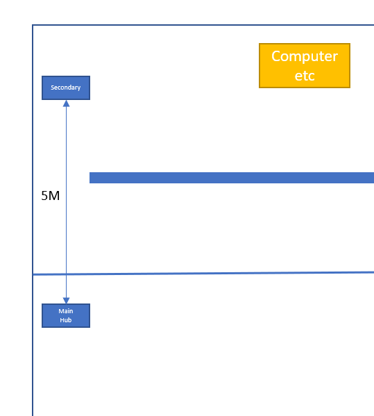

No machines could get wifi on the other side of the wall unless in doorway which gave me an idea.
EXample of what I am dealing with basically, blue lines are walls, Im, in a extension other side of double exterior brick wall, no wifi could get to my computer or to the play room upstairs due to wall, I position the APs such that I could utilize the door opening and only have to deal with single brick wall :D

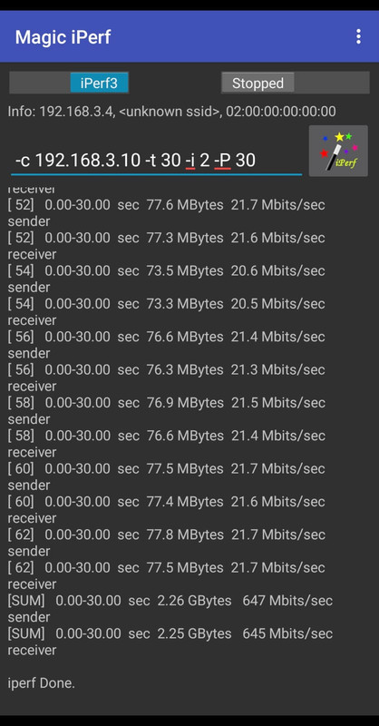

Below is an example of performance in this scenario, wifi AP to Wifi AP with machines wired into APs. Iperf is from S10 connected by usb ethernet on my Dex setup, not wifi.
Most wifi stuff doesn't need the speed, just my desktop, so I focused on getting best signal there, works well.

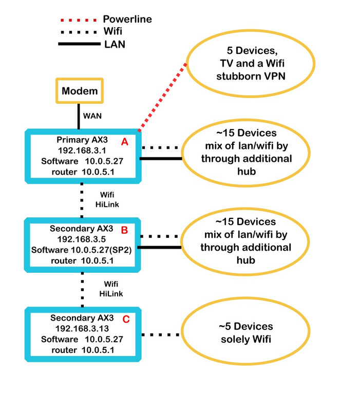

The problem with this setup is that hoping through APs the speed drops off a lot, so upstairs didn't get as much as me, an it wasn't as solid, wavered between 200-400Mbps but it is ~9m away router to router through ceiling, crude topology of my network botchup. :D

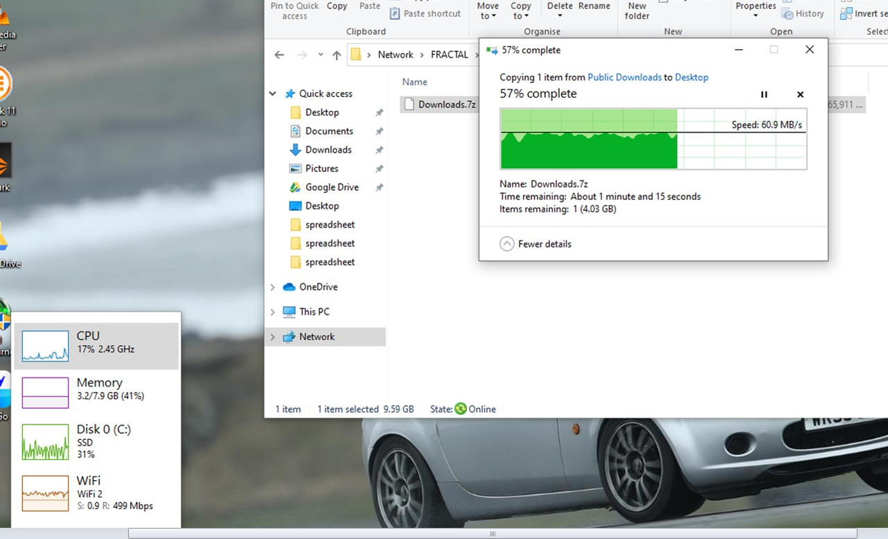

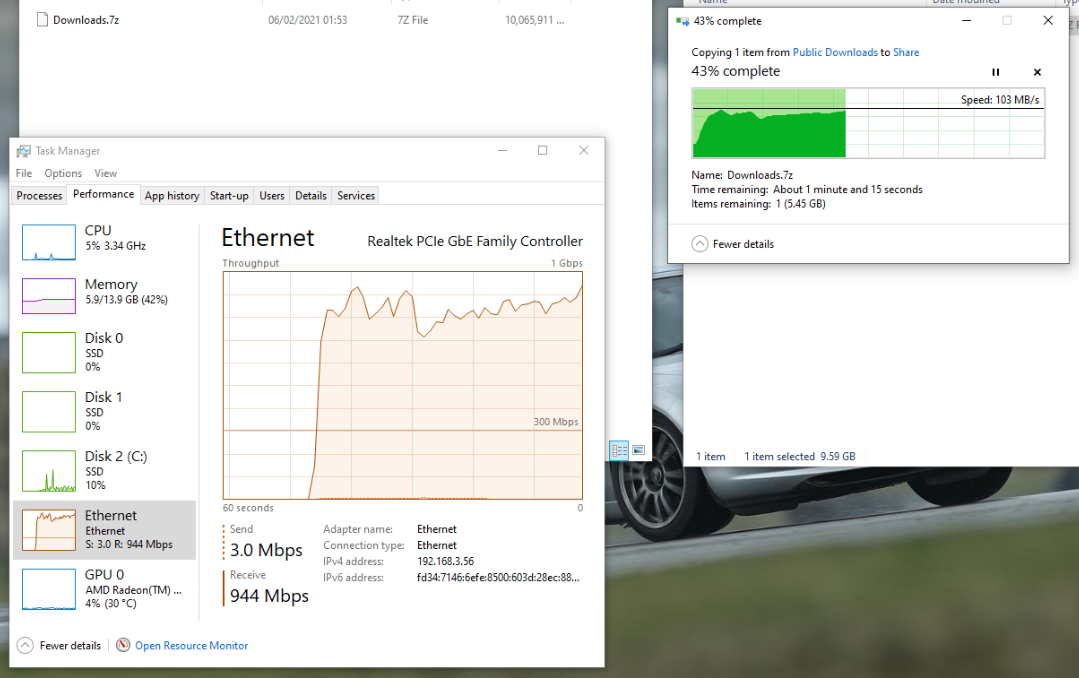

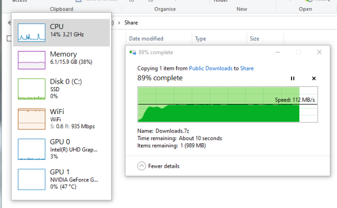

Good stuff, I set mine up to 160MHz on the 5GHz radio which might be a bit limiting with lot of 5ghz devices but ax3 to ax3 I am maxing out the 1Gb LAN port which really surprised me for wifi, ~112MB/s to my NAS from my laptop on wifi, who needs wires :D performance is not so hot hopping to a third due to lack of back haul but still very respectable.
160Mhz Wifi 6 transfers
below laptop wifi 5 wave 2 160Mhz transfer to PC on same ax3 which is connected on a LAN port
and then upstairs to downstairs, front to back of house, ax3 to ax3 PC transfer via LAN connected machines on each AX3, you can see its not as stable but still damn fast. I'm impressed.
