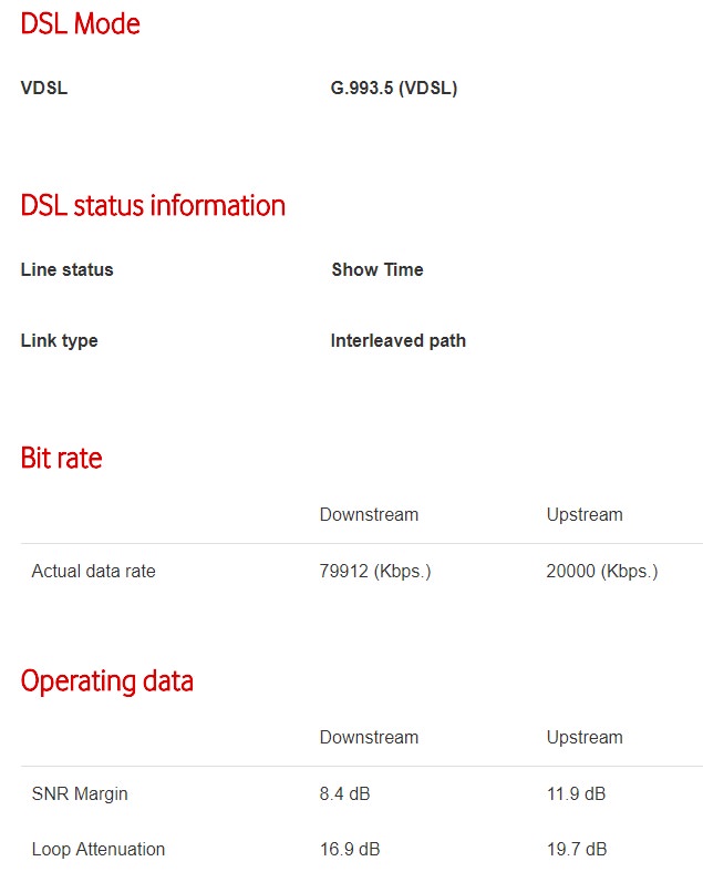

I'm back with my Vodafone router at the moment - it seems to think I am:

As I said, I wasn't particularly worried as my connection seems quick, stable and low latency and at the end of the day nothing can be changed.
Just wondered if there was a "classic test" to see if interleaved was having any major effect on a connection.

9ms to BBC for me on BT infinity 80mb with fast path from Gloucestershire. Seems the interleaving is minimal based on your result, probably wouldn't worry about it.
