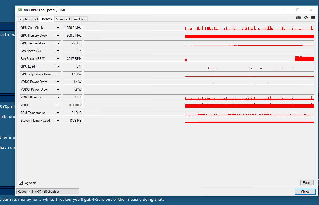

Hey all - have had a Sapphire Rx480 Nitro+ from new. Recently and I guess intermittently the fans go 100% - no gaming - can be youtube or actually right now posting this...
Checking CPUZ gives me the below status... so no load etc but then just ramps up for no reason. Wattman says fans are at 0 currently - have chatted with Sapphire tech ... they advised me sending video of the fans.... various driver installs... uninstall TRixx (which is now not installed)
Raised an RMA couple of days ago then all seemed fine... now it has just happened again. Am worried if I RMA the card is it will seem fine and they send it back ... anybody had any experience of an issue like this?
Ive tried to eliminate a software or driver fault.... even rebooting the system now the fan still 100% ... but I could leave it for 30 minutes and then it could calm down. I dont do a lot of gaming to be honest so hard to pinpoint.
in the graph see how it just goes full throttle ?
am running windows 10
Just RMA ?

Do you use Afterburner? Have you tried to uninstall it completely, use DDU to wipe the drivers and install fresh the 18.9.3?
Hi - have tried afterburner... Trixx ... without both... installed latest driver..... rolled back a couple.... last week tried DDU in safe mode etc... reinstalled.... thought it was ok for a couple of days ago... then something seems to make it go nuts... still at 100 .... tried cc cleaner and virus check for anything nasty... found nothing.
Also have taken out fans a while go to clean... nothing much dust wise in there.... installed back correctly.
latest gpuz ...
rebooted a couple of times... fans still at full wack... left off pc for 10 mins or so.... fans back to normal.... I bet they ramp up soon enough.... .....haha as i type ... full wack...
got to be hardware fault ?
gpuz after reboot.... and fans at 0 ... notice the blip at full wack again... then they slowing and wirring ... and now 0
