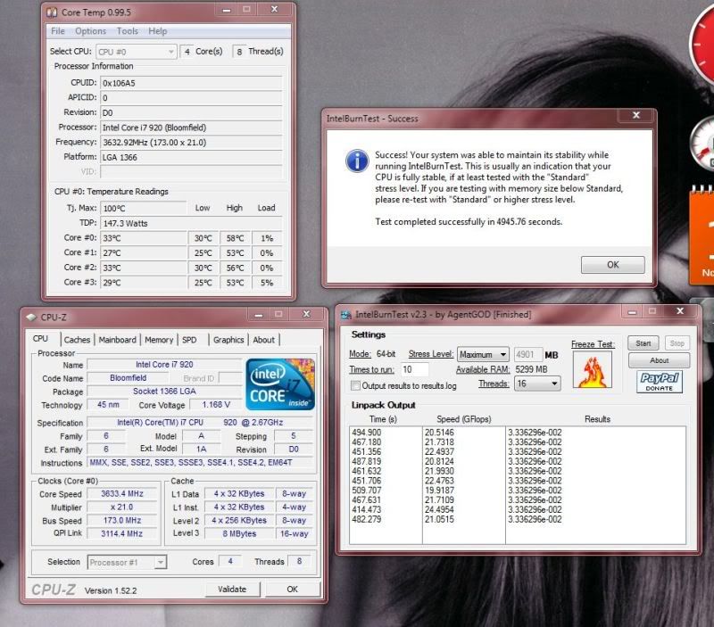

Im currently in the midde of overclocking my i7 920, i fancy using ibt as a quick stress tester. My questions are.
1, should i select maximum stress level.
2, how many threads, (currently on auto)
Im not to familiar with ibt having mainly used p95 for stability testing in the past. Thanks in advance.
I haven't used IBT for a while now, but when I used to use it, there was a bug where when using i7 processors you had to select 16 threads, because when you used 8 threads it didn't fully load the processor.
And as for the stress level, I always used the max setting.
I don't know if this bug is still present or not, but that was the reason I started using LinX instead, as it uses the same testing method as IBT (Linpack) but it doesn't have the 8 thread bug.
Thanks davy, been doing a bit of testing with p95 small fft in the meantime, passed over half an hour at both 3.2ghz and 3.4ghz, ive upped the bclk to 173x21, will give ibt a quick blast to see how it fares, havent had to change the voltages from lowest settings so far, (1.18 vcore), vtt, 1.21250 and 1.8 pll.
Ran ibt for 10 passes (will probly try more later), passed fine, max temps recorded, 58-53-56-53.
