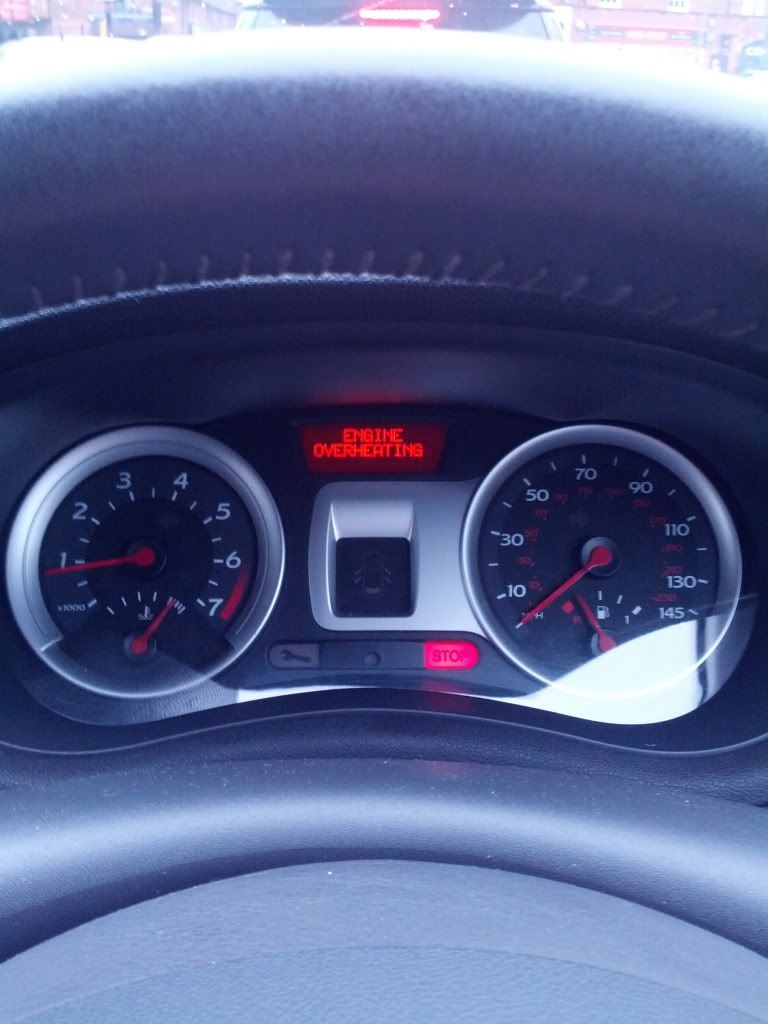

Seems you guys might be right, on the way to them this morning (after 5 minutes driving) with the temp needle all over the shop I get this:
Because I was stuck at the traffic lights in town. It had just come on at this point. I was a minute away from them.
Yes they did change the water pump. The car is also not blowing any warm air when the heater is on.
It is with them now so I wont be driving it until it is sorted, I am not happy. :mad:
They've just phoned and said it was an airlock in the system, they've had it running since fixing it and it hasn't came up with the warning again. All re-filled with coolant and system drained.

Why the hell is it still running while you took the photo?
To be fair the only indications of a problem is a temperature gauge in the red, a red warning light marked STOP, and a text message saying "Engine Overheating". Nothing to really imply you should pull over and stop the car immediatly :P
