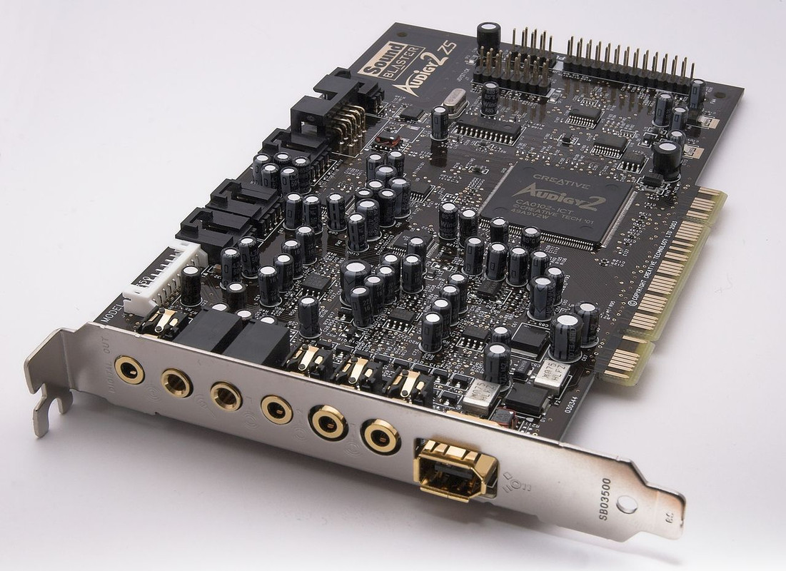

I am not 100% sure but Firewire or 1394 were not always 100% exactly the same like on Creatives Soundcards not sure why they even added it TBH.
Bit tired to look up now, though.
https://en.wikipedia.org/wiki/Sound_Blaster_Audigy
