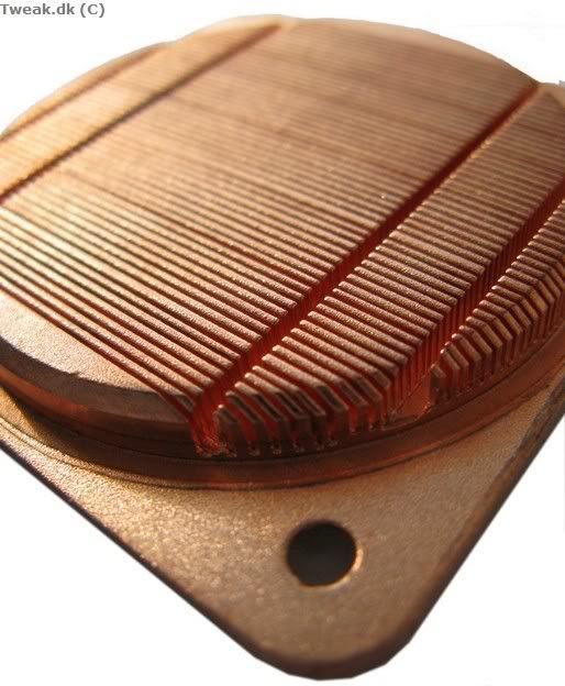

Are you using a CNC mlling machine? If so I'd go for a deep parallel fin design if I were making it, with the fins as tall and as narrow as the drill bits will allow before breaking - something like a 1cm tall fin, .5mm-1mm wide fin design, and sandblasted after if you have access to a sandblaster to increase surface area and turbulence would have utterly brilliant cooling - better than the best available commercially. The XSPC edge has around 54-55 fins , each ~0.3mm wide and 3mm tall:
If you had slightly wider, but much taller fins, covering the entirety of the IHS (with the inlet and outlet off to the sides) it would perform much better, with very low pressure loss and massive surface area for heat transfer. I don't know the numbers on the heat transfer from the base to the fins, and I expect there's a trade-off between fin width and height - the thinner the fins the more you have but the bigger the heat differential between the fin temperature at the base compared to the top, but I suspect commercial companies haven't released taller finned blocks due to cost of copper and machining rather than performance.
Theres a really good reason why the edge does not have deeper, thinner fins. You can't cut them on a milling machine. The best you can do with a 3mm diameter cutter is about 6 mm deep. That'll break often. A 1mm milling bit stands a fair chance of managing a 1mm deep groove, but even that is pushing it a bit. Even under cnc.
Now the above is different, that can be cut with a slot cutter. Big cutting disk, moved in from the side. This is much better than a milling bit for small channels, but you need to be able to have the ends open. If doing this on a mill, I recommend talking to the technicians there. Limitations of the milling machine are a large part of why I haven't settled on a design yet.
Finally copper is a bitch to work with. Lovely ductile cutter grabs and holds onto cutting bits, so feed speeds and spindle speeds need to be carefully chosen. CNC would help greatly for this, but I'll probably be cutting mine by hand in a few months
Aha, okay, thanks for that.
Aha! Many thanks again - is there a rough guide for width of slot compared to depth achievable with a slot cutter?
