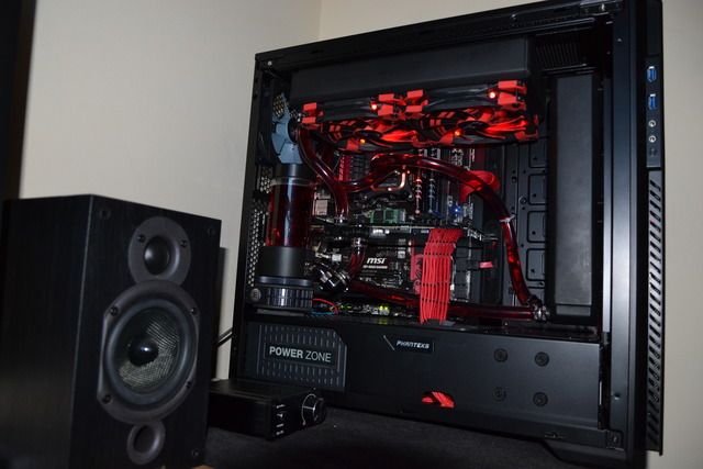

X2 360 rads may be tight
You can get a 360 rad in the roof if you remove the drive bay, but I think you can only fit a 240 or 280 in the front if you have already fitted a 360.
I'll get the tape measure out & check for you as I have the same case & have a 280mm in roof & 240mm in front.
If you can it would mean removing the Lower hard drive caddy, & it still would be tight.
Other than that it looks good

Thanks for the advice, what brand/model radiators do you have in your case?
Make sure you check which revision of the TF5 970 you have.There are two separate revisions,aswell as 2 separate revisions of the FC block and you need to get the correct one to fit the card.
