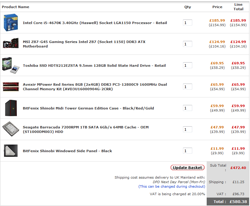

Hi there,
I have finally decided to bite the bullet and build my first gaming PC, and would like the forum to help me decide on some components.
I have around 600-700 pounds to spend on my computer, please tell me what you think about some of the items I am thinking about purchasing and whether they are all compatible with each other.
CPU: Possibly Intel 4770K
Motherboard: Not really sure on the best choice, ideally would like it to have some processor OC settings built in as I would like to OC but am not really sure where to start.
RAM: I noticed there is a deal on RAM today (GeIL EVO?) that seems good at first glance, I am able to purchase items today so is this a good deal?
HD: Would like a small amount of SSD to be able to store my OS and a few of my most used games, then a simple 1TB drive will be more than enough.
Graphics Card: I have an MSI 7950 card left from my previous build, this has be able to work with all other parts in my system as this is what I will be using.
PSU: I also have a Corsair CX600 lying around, Will this be sufficient and also compatible with this system?
Case: BitFenix Shinobi "Core" seems like the case I like the aesthetics of, will this fit all of my parts?
CPU cooler: I have an Akasa Voodoo Venom CPU cooler, I believe this is compatible with the CPU I mentioned above and would need to be compatible if the CPU is changed.
Case Fans: I also have a couple Akasa fans leftover, will 2 be enough to enable good airflow or will I need more?
I would also like a cheap DVD Drive just incase, can be the cheapest one possible.
Thanks in advance for your help

From what you have said......
YOUR BASKET
1 x Intel Core i7-4770K 3.50GHz (Haswell) Socket LGA1150 Processor - OEM £245.99
1 x Gigabyte Z87-D3HP Intel Z87 (Socket 1150) DDR3 ATX Motherboard £109.99
1 x BitFenix Ronin Tower Case - Black £69.95
1 x Toshiba SSD HDTS212EZSTA 9.5mm 128GB Solid State Hard Drive - Retail £69.95
1 x Patriot Viper "Sapphire Blue" 8GB (2x4GB) DDR3 PC3-14900C9 1866MHz Dual Channel Kit (PV38G186C9KBL) £65.99
1 x Seagate Barracuda 7200RPM 1TB SATA 6Gb/s 64MB Cache - OEM (ST1000DM003) HDD £47.99
1 x Corsair Hydro H100 Extreme Performance Liquid CPU Cooler *Manufacturer Refurbished Unit - 90 Day Guarantee £44.99
1 x OcUK 20x DVD±RW SATA ReWriter (Black) - OEM £12.95
Total : £681.29 (includes shipping : £11.25).
The OEM CPU has a shorter warranty and no stock heatsink but it is a fair saving over the retail version. The mobo includes a decent free heatsink so the H100 can be omitted, it's there because the Ronin (the updated Shinobi essentially) can mount 240mm rads unlike the Shinobi.

Yes I did notice he had the Venom Cooler and I also noticed how you nicely matched the yellow into your spec ;)
The D3HP does all he is asking for very well, I can't help that it comes with a free cooler ;) I prefer the Ronin to the 300R as the fan vents in the 300Rs window and the Shinobi bug me, case is a personal preference though. The 300R and Shinobi can't mount the H100 but the Ronin can, he might not care about that but it's nice to know the case offers pretty decent watercooling options for a similar price :)
The MPower is overkill, as he does`nt want to clock it himself. I did have a look at some of the Overclocked bundles, but they seem rather expensive for what you get. The same goes for the OC`ed gaming systems.

Also I would like to ask if on my budget people think it's worth buying the 4770K over the 4670K, the £65 price difference is big and I'm not sure what applications are able to take advantage of the extra 4 threads, advice please?

The i7s Hypertheading is mainly for video editing etc but some games will perform better with it. The i5K is still a very good all round CPU it just lacks the hyperthreading.
