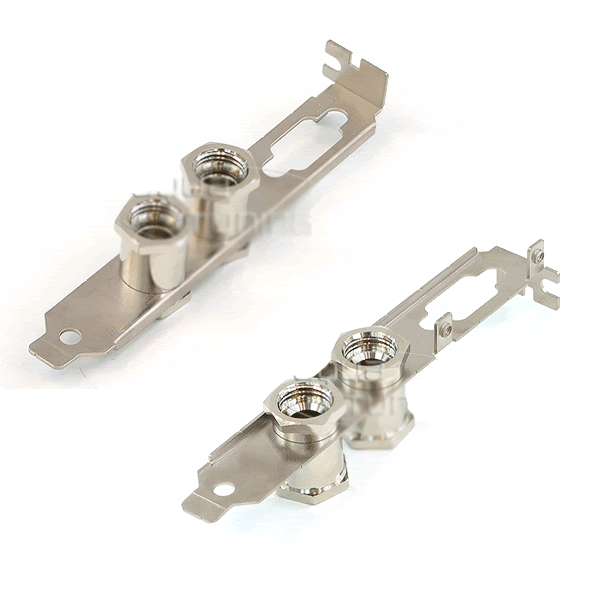

Not sure if this has pre drilled holes but you could use one of these which would overcome that.
There like £12 a go.
