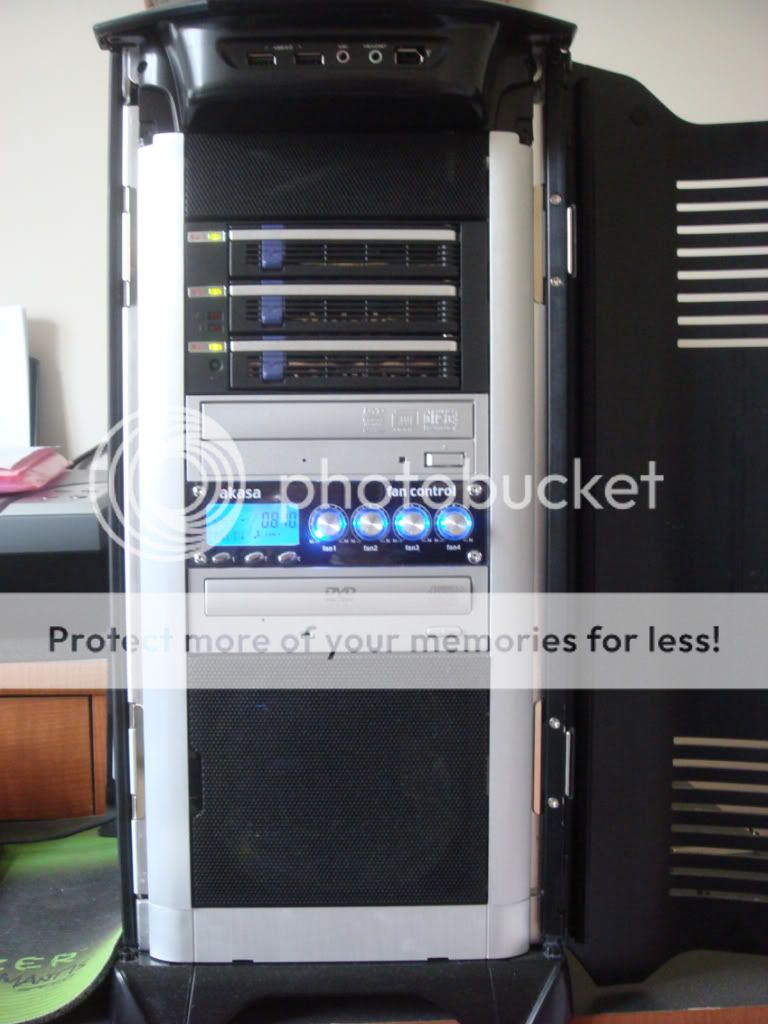

The obligatory external “before” shot:

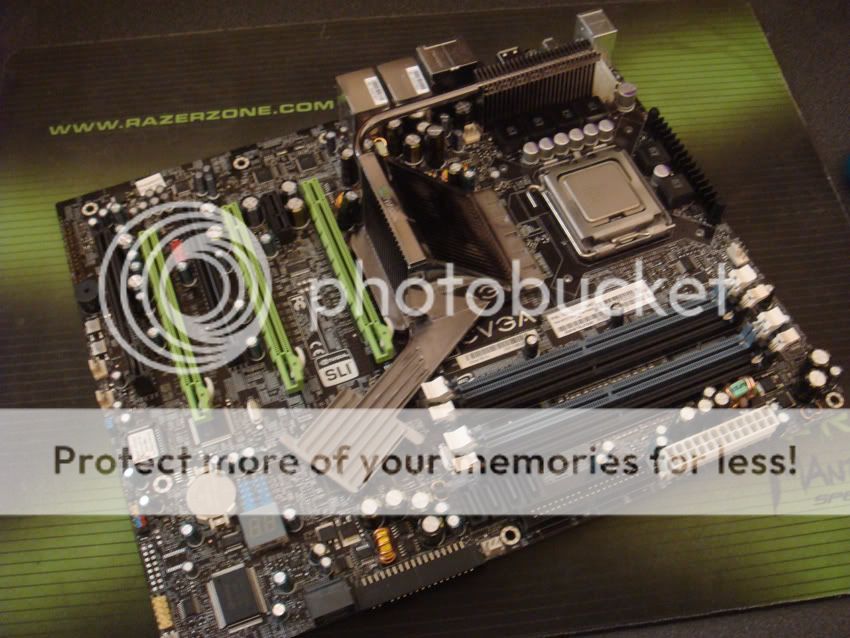

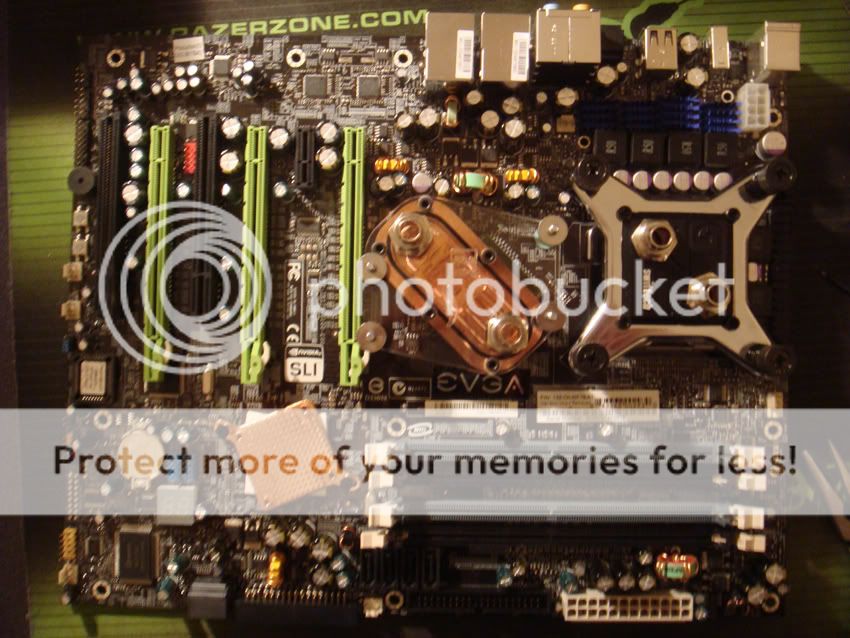

I whipped the TRUE off and got the mobo disconnected and removed from the case:

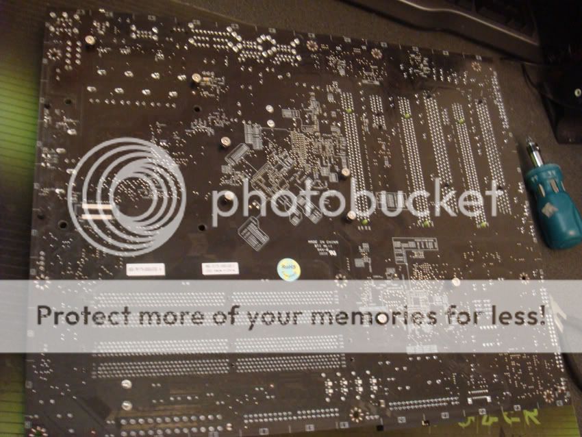

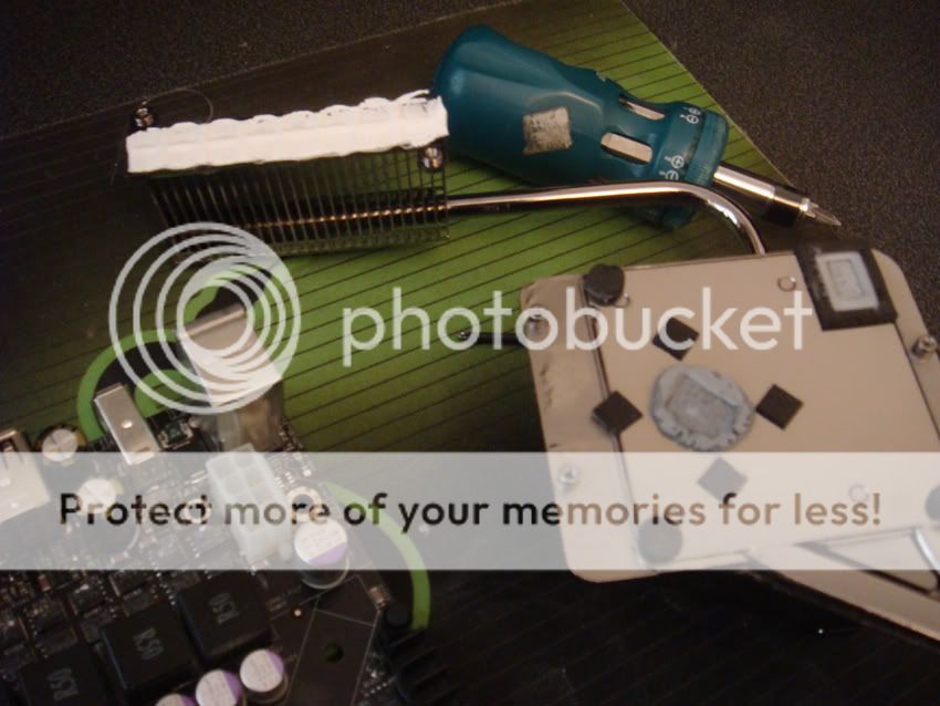

Flipped it over and whipped off the 8 sprung screws holding the heat sink arrangement on

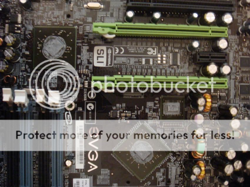

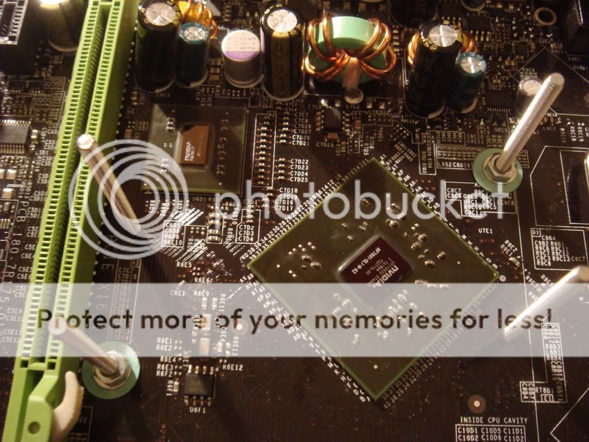

Once removed (with a bit of tugging and a sphincter twitching crack) the whole thing gave way revealing that EVGA haven’t skimped on thermal paste and pads, in fact they appear to have heaped it on
So once the chips were all nicely cleaned up I installed the back plate for the CPU block and retaining screws for the NB block

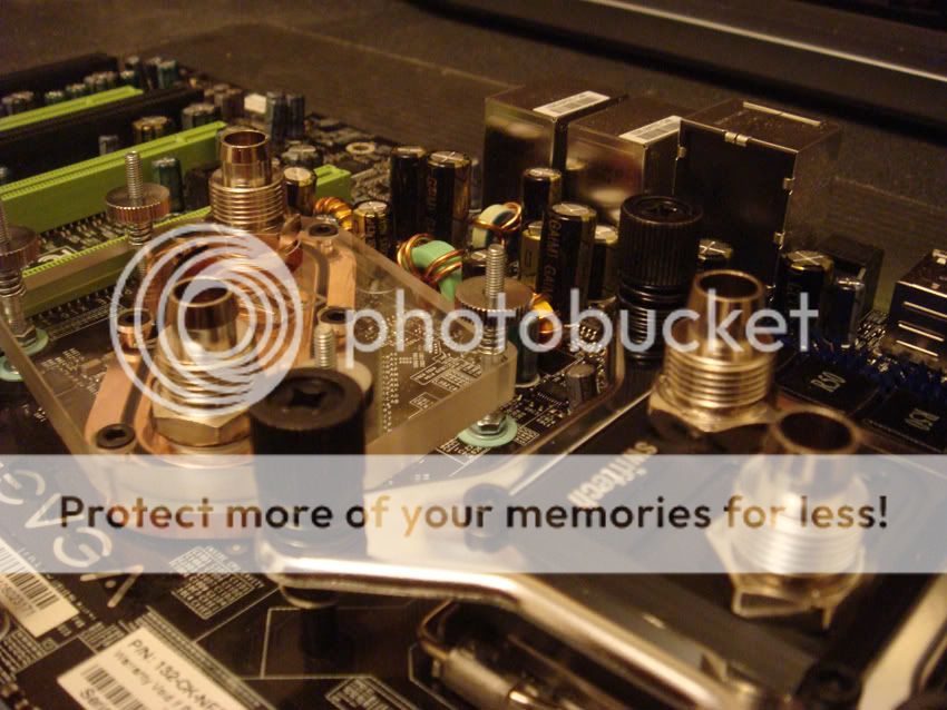

The bocks went on relatively easy, in fact the SB heatsink was the biggest pain (as you can see the one I went for sits at odd angle, but does the job) :P

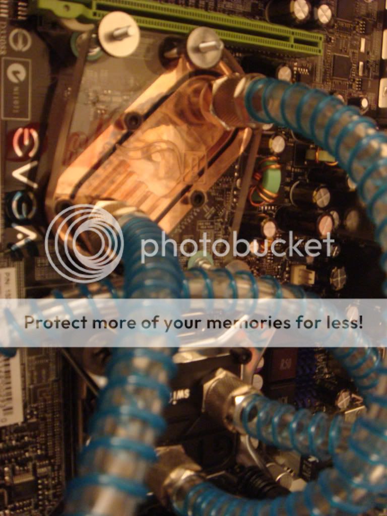

Close up of the blocks in place
I tubed it up, filled the res and ran it for about a week to leak test and wait until the remaining fans were delivered along with getting myself a jigsaw to attack the case with :P Up until now the rad had been sitting on the inside bottom of the case with three temporary fans just sat in top, needless to say my temps were actually worse than under the TRUE, by quite a bit.

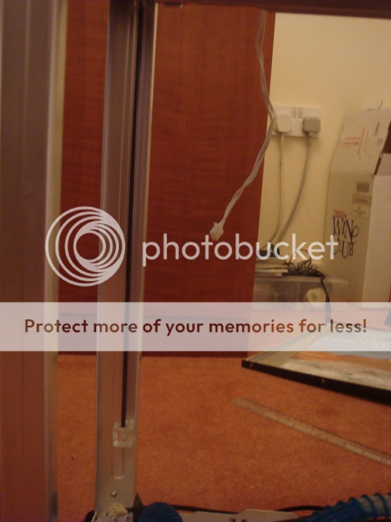

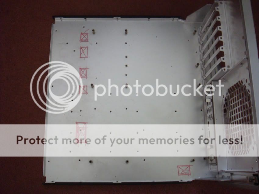

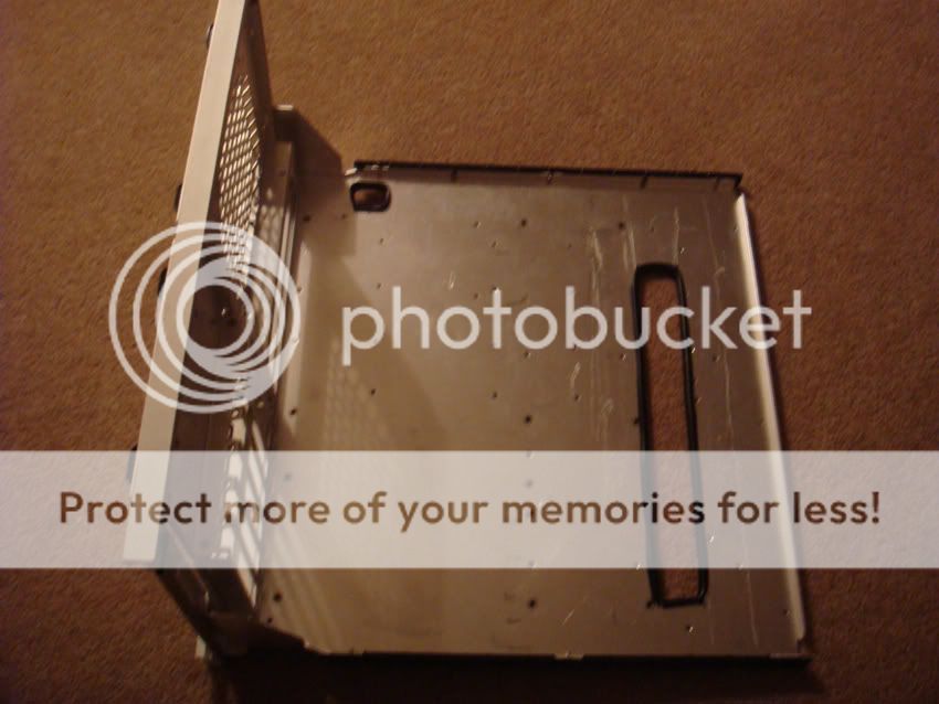

So once all the parts arrived, I stripped the machine back down again and marked up the mobo tray and bottom of the case for my jigsaw antics
Cutting the small holes on the mobo tray proved very fiddly and if im being honest a right mess, so off to plan two, one big hole ;)
Once cut I used some edging to finish off the holes id cut

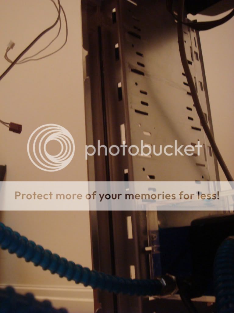

In the end the edging to the bottom of the case was actually reducing the purchase of the screws into the rad, and you couldn’t see it anyway with the rad and fans in place, so I removed it and fitted the rad under the base of the case, with the three fans bolted on top, sitting on the floor of the case sucking air up from under the case, through the rad.
I then “discreetly” installed the two UV tubes in the reveal of the front frame, one either side

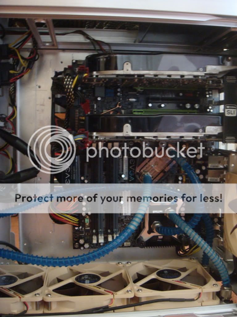

From there on it was pretty plain sailing getting the mobo in and taking some time to route the cables down the back of the mobo tray and through the hole id jigsawed out:

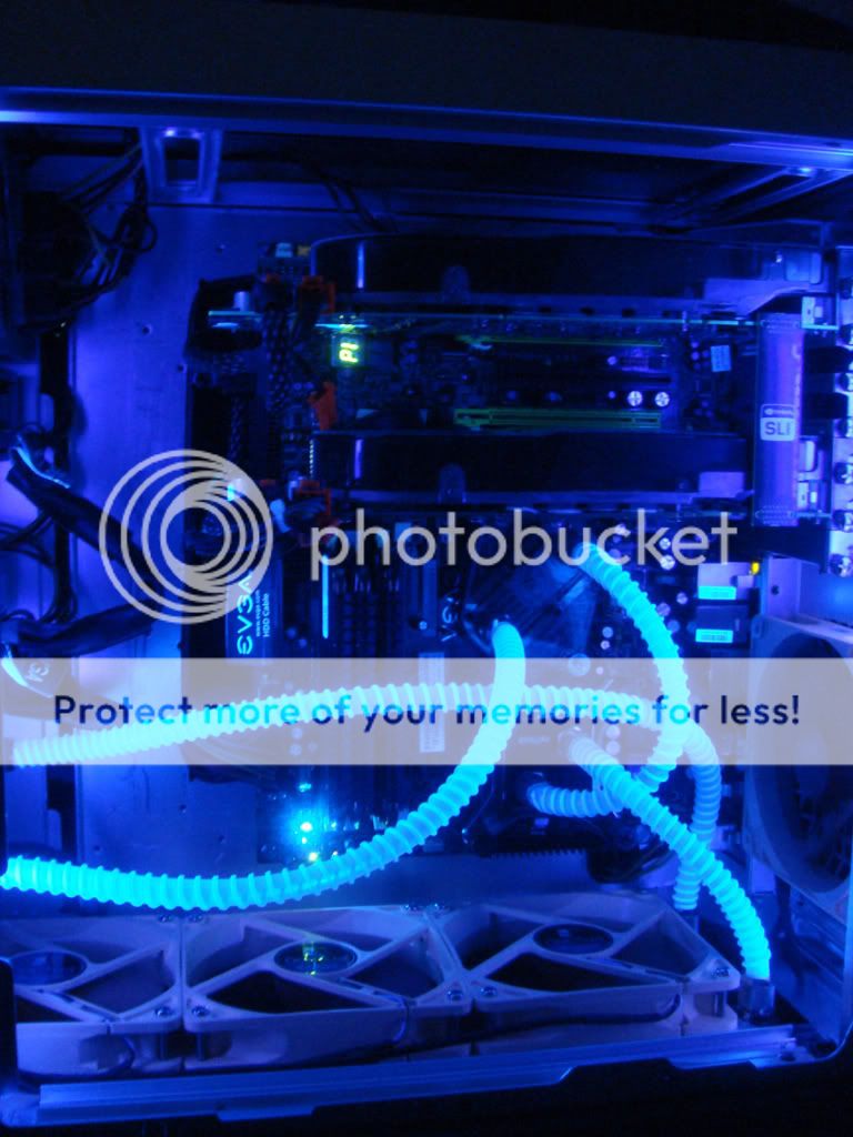

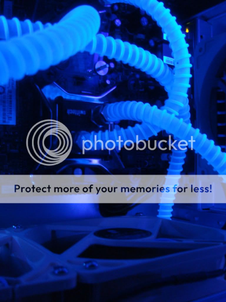

Lights out, UVs on
So after a few hours with the rad being it its new place the temps have dropped to just under what the TRUE gave on a cold day. Im hoping that when the AS5 cures I will get more of a drop, but have noticed that under load they are a lot lower that the TRUE gave.
