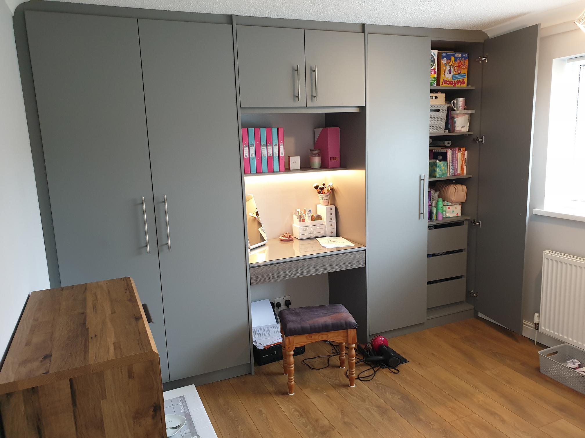

Any of you guys that built-in IKEA Pax care to show any pics or guides? We’d quite like to do that in our new loft next to the chimney part of the wall. Seems silly to build anything in as it’s not actually an alcove, but I’d like it t
Sorry no photos so I will try to describe as best I can. The way ours was 'built in' was on a base that was raised up enough to get the bottom just above the height of existing skirting, made from CLS and screwed into the wall then skirting attached to the front.
Up the sides and above was framed with more CLS and MDF attached.
