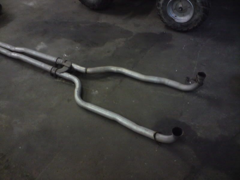

Kinda guessed the answer though - mine'd be such a doddle on a ramp, instead of doing it on stands or jacks, plus the hassle of trekking back and forth (plus the cost) finding the right hangers, paste, wire and whatever else.....
3 very important bits missing from that picture, that you'd otherwise find on the stock system ;) :p
