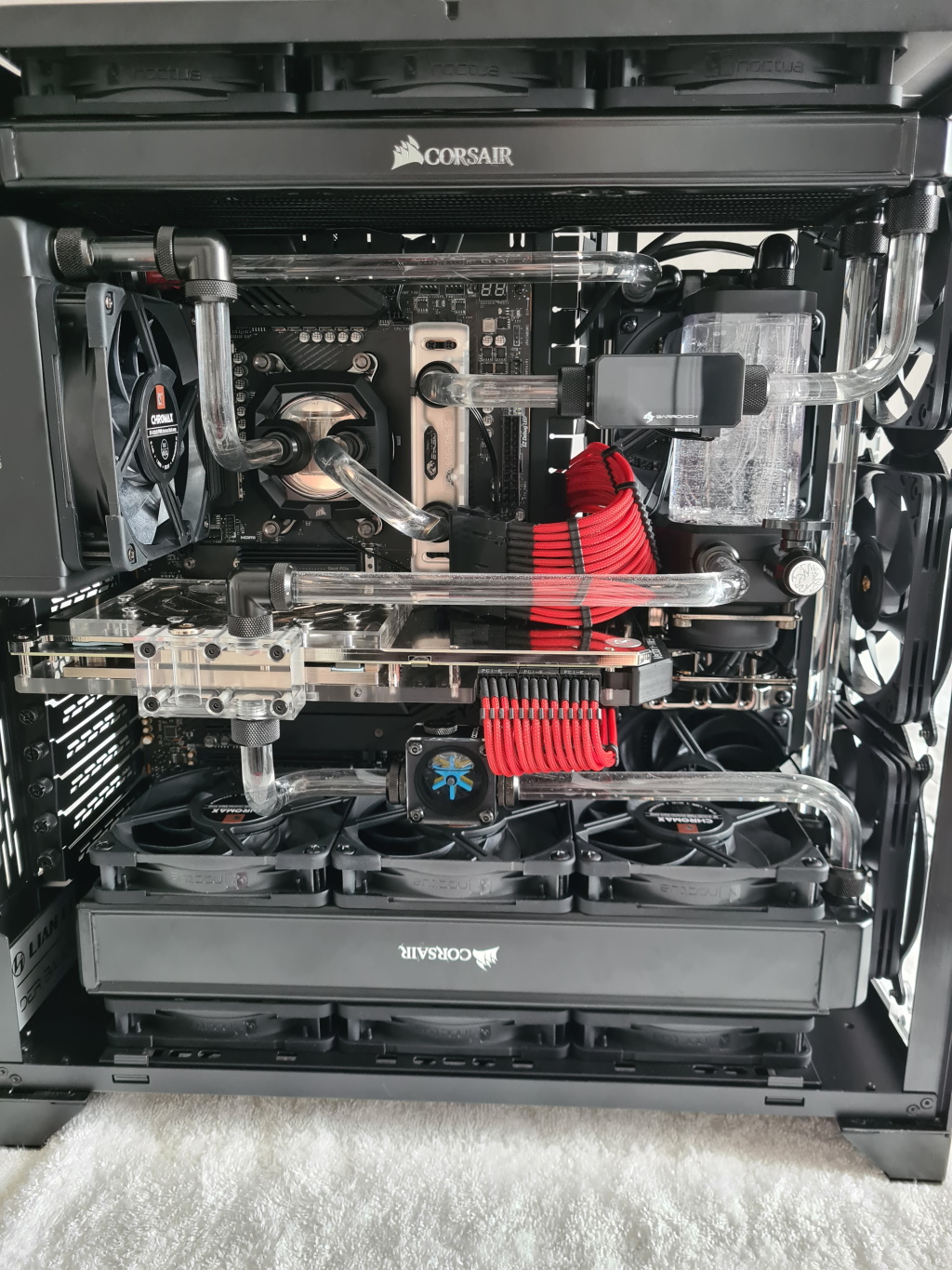

@kosch I just mentioned the intake from the active backplate because I was trying some funny tubing run here. If I remember well, I messed using lets say the port closer to the power connectors of the card from the GPU block as intake, and the port closer to the I/O port from the active backplate as outlet. Don't ask me why... :D:D:D

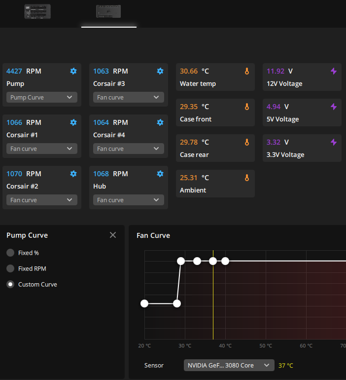

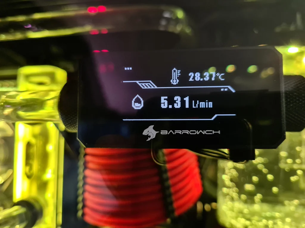

OP I run 4 radiators in a XL and 4 blocks, flow rate is fine.
On a single D5 I get this at 100%
Though these flow meters usually over estimate. Still, my temps are fine
Those are my temps at around 85% on the pump under a 500w load. I allow the pump to drop down to around 2000RPM on idle/desktop for complete silence. Flow rate measures about 0.42l/min, but this is absolutely fine for no real load.
I've played around with 60~85% on the pump under load, basically no temp difference, maybe the graphics card going up 1 degree between those two speeds. So I just settled on what has the most tolerable noise on the pump and that is around 85%. It's more high-pitched whirr than the deeper sound around 60~70%.
