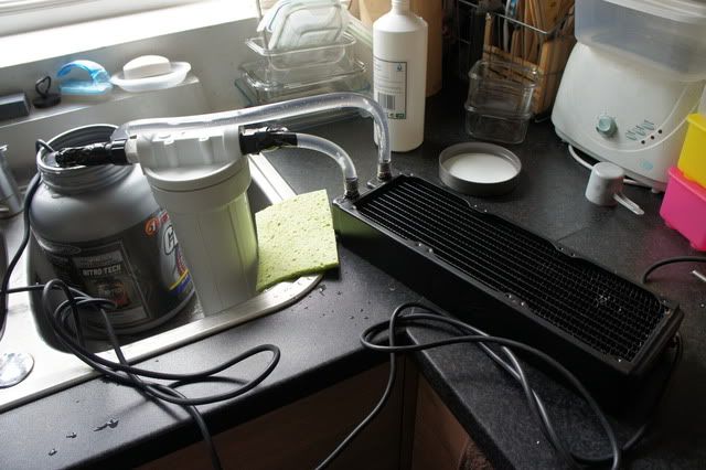

This is what i did
Submersive garden pump
Tub of sorts preferably with opening big enough to drop a garden submersive pump into.
Inline water filter
some di ionised water
Leave for a few hours cycling through
and your good to go

Just flushed a radiator for the first time. I filled it with hot tap water and shook it around for a while and then drained it. I used a clear glass to check how clean the water was coming out. From the first flush it seemed really clean to me. Maybe the odd specs of dust. Nevertheless I repeated that flush method 4 or 5 times, then flushed it with deionised water a couple of times.
Will that be okay? Or do I need to run it in a loop for a few hours like people have suggested here?
try it like this,pump with the inlet in the sink,the outlet from the rad can go into a pot and the clean over flowing water will go back into the sink
