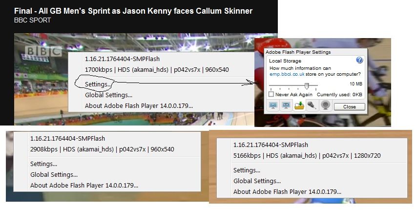

If you set the flash cache to 1MB or greater, it gives a more consistent 720 feed for me, I suspect have a wired connection would help too (if you are not running a metered wireless connection like me to prevent 10 updates)

flash options are off of the context menu (m3) inside video area

the bit rates I show evolved as a I started watching the live cycling stream, and peaked at 720 after about 60s ,wireless connection, my bb peak 8Mb/s

As for the Flash cache, my screen only says Allow or Deny. It doesn't show any storage slider. But I'm on Flash v22, you're on 14. Maybe they ditched it?
