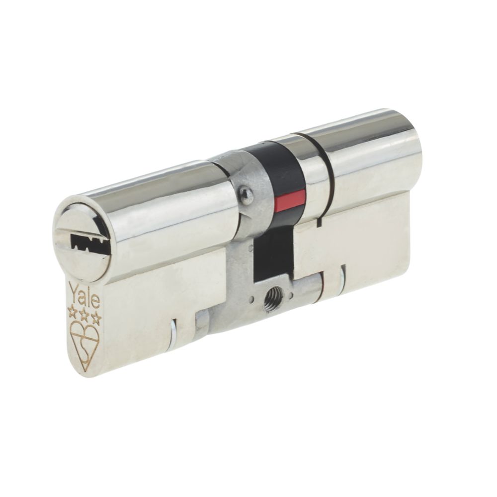

Yale 3 Star Platinum Cylinder would be the best choice:
I however fitted this a Yale Superior when I replaced one of my locks (as the Platinum wasn't in stock locally and I needed it in a hurry)
Both are regarded as fairly difficult to pick etc.

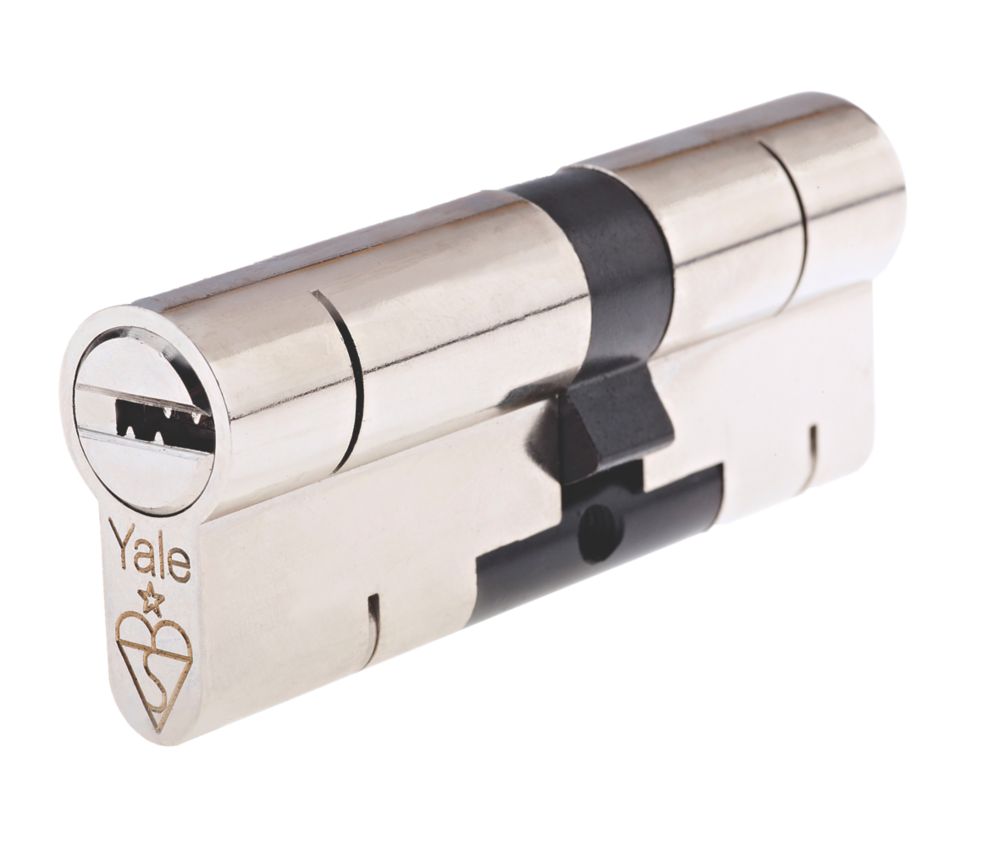

I bought these:
Easiest thing to do was whip the current cylinder out, measure it up, then find the cheapest Yale anti-snap/BS logo.
Misleading advert, 1 star rating cylinders are only classed as anti snap when coupled with 2 star door furniture.
For the sake of a few ££ more just go for a 3 star cylinder. I have the 3 star yales, but as above, the ABS or Ultion are rated pretty well also
Be careful about the 'Yale 3 star platinum locks' - they have nubs/bumps on them so they don't fit every standard euro-lock keyway.
