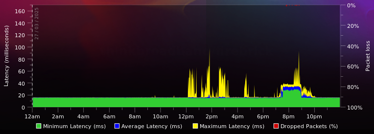

You will love it, notice that loaded latency, that will be a thing of the past.
