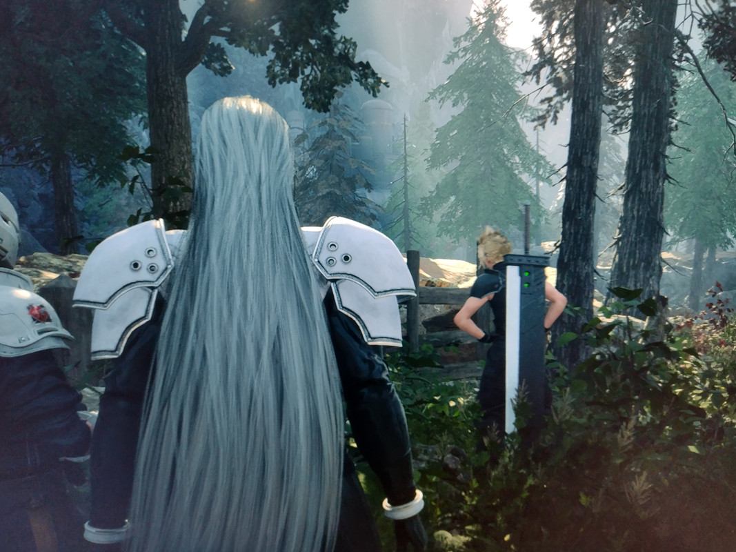

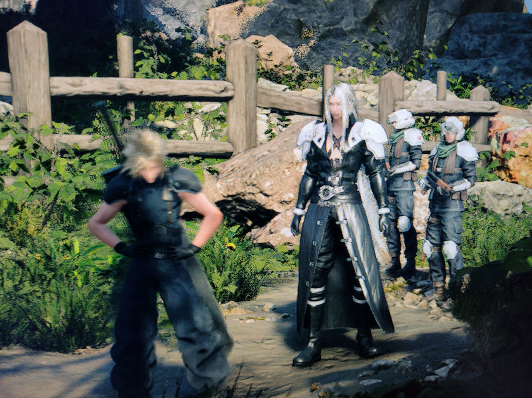

Steam remote play was great but the graphics quality was not impressive.
Downstairs
Back on PC upstairs
Compression...
Downstairs
Back on PC upstairs
Steam remote is rubbish, it's laggy and quality is poor as you noticed
