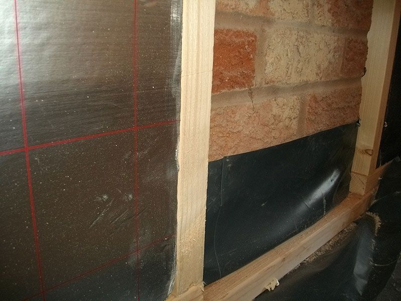

    I would go for the better/cheaper/easier option of laying down damp proof membrane up to a few courses higher than ground level and add an air brick of too to let moisture evaporate.
    Its a better idea to plan to allow some moisture into the space between the stud and allow it to evaporate.

    @eviled
    Just wondering. Is it normal to scribe the battons to the brickwork? Feels like a lot of effort considering the number required.

    @Marvt74 that picture isn't mine, and it looks like studding around a brick column, I was just using it to illustrate the damp proof membrane on the floor coming up into the cavity
    the idea in this case is to leave a gap to allow ait to circulate and dry out rather than transmit damp through contact.
