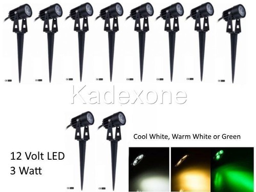

But I would buy spike lights. If you look at them (check) most have a single bolt between the light and the spike.
Just don't use the spike, flip them over and you can screw them to the fence post through the hole the spike would be attached through.
Eg these, if you scroll down on the add you can see a picture not on the spike mount
These are what I have

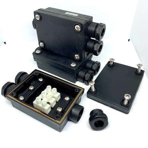

On top, some kind of switch (i used a timed and light detecting one, but anything would do), some extra cable (pond cable is ideal), your choice of bulbs (gu10 choose wattage and colour temp), and IP rated boxes, somethign like this
