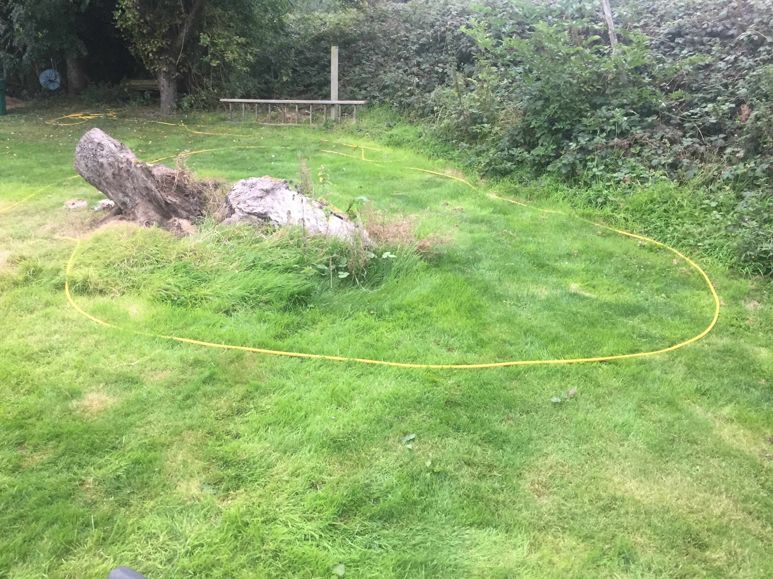

An apple tree ha blew donw last week in my garden. The neighbour a grounds man with a digger came and cut it up with his chainsaw and took the logs. I have just finished today buring the rest of it nd Iv'e been left with a huge stump. My neighbour say he will be coming down in the week to dig it up with his digger, level the ground so we can mow the area.
I was sat done the bottom of the garden and it suddenly dawned on me a pond would be really cool.
I'll take pictures tomorrow and get some input![]()
It depends on your budget but that's a very ambitious sized pond for someone starting out really and assuming you want to keep fish in it.
Could cost from a few thousand to tens of thousands, it's a too open question to answer but it's the build cost and equipment that will be the biggest expense. The maintenance cost would be low in comparison as it's just mainly food, water and electricity charges.
Some things to consider in the build cost:
Excavation
Foundation work/ supporting wall
Bottom drain and pipe work
Underlay and liner or fibre glassing
Decoration/rockery/waterfall feature
Equipment:
Filter
Pump
Media
UV lighting
Skimmer
You can of course have a natural pond with lots of plants to do the biological filtering meaning you can exclude a lot of the equipment in the above list. You won't be able to keep things like koi fish in there though.
Foundation and wall if you want a pond that's part under and part overground. You can keep fish in a natural pond, but that depends on how many you want to keep. You won't get that crystal clear water you'll find in a regular pond with a pump/filter setup however.
There isn't a minimum depth per say for a pond. It's mainly to do with reducing predators getting at your fish and overwintering where there is a risk of the pond freezing solid and killing your stock. The deeper the better but most people aim to have an area where it is at least 4-5 feet deep. You could go less if the pond is heated.
