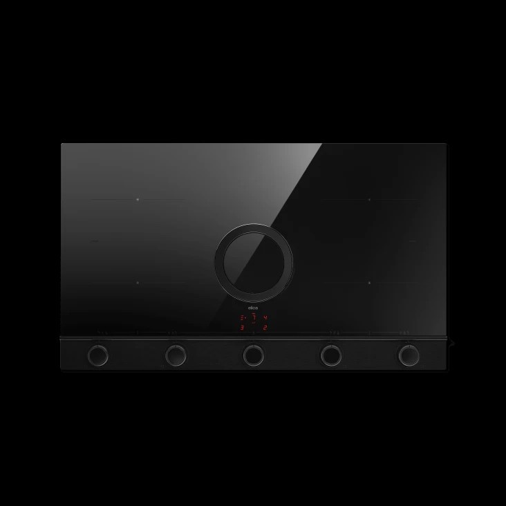

We moved from gas to induction when we did our kitchen extension. I'd cooked at my brother's place (induction) and was happy with the instant on/off that induction can do (no difference really to gas). But HATED the stabby buttons to turn the heat up and down.
In the end we got an induction hob with a rotary knob for each ring. Cant fault it. The central extraction also works well - it re-circulates and deals well with smells and smoke, but there is no point doing steam as it will either condense in the venting system or come out as moist air anyway. Wish we could have externally vented, but the hob is simply to far from an external wall.
The hob is made by Elica - overpriced, but seems well made, luckily we got it on sale.
