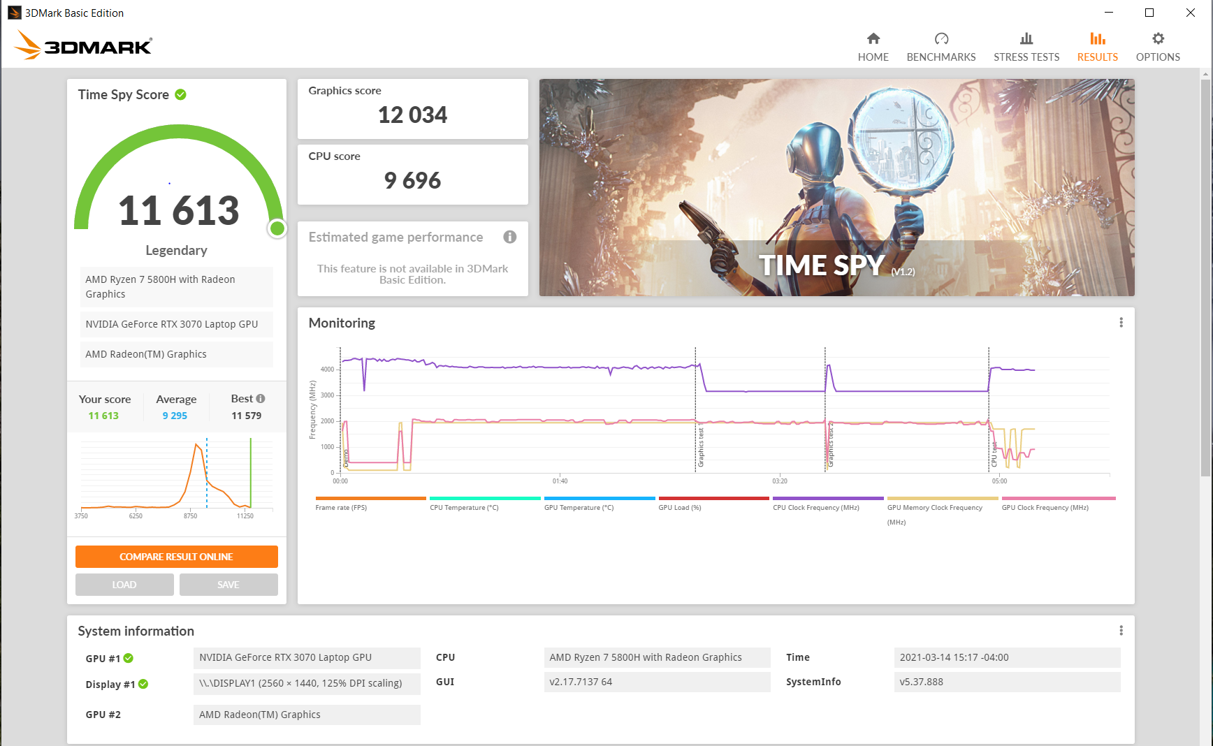

One other thing and this is for any GE66 owners out there, during your Timespy runs are you able to get the GPU core to go higher than 1,750 or so? It boosts higher than that during the demo part of the benchmark, but for the actual benchmark I can't seem to get it higher than 1,750 or so no matter what I do, yet during games it can go as high as 2,050. It's very strange.

That's normal and probably normal for desktop GPUs.
(I spent too much some time looking at the MSI AB monitoring charts when I initially got mine - I like to understand what's going on so I can work with the limitations.)
Different scenes pose different amounts of stress on the GPU - a simple scene may not require much complexity, in which case fewer components of the chip are being used, so it can boost up to ~2100 Mhz before being power-limited.
You can also try with different benchmarks - e.g. Unigine Valley, the clockspeed is all over the place, but Superposition the clockspeed stays pretty low because the GPU is really taxed.
Take a look at the "Power Limit" plot in MSI AB.
I always like to see the power, voltage and temp limits to see which one is limiting. I don't think I've ever seen a temp limit on this GE66, which is good. It's always power, which is why that 140 W vBIOS mentioned elsewhere would be beneficial. I don't think I can be bothered for the sake of 10W though. (My 2060 was frustratingly power limited to about 85W, so flashing that to 115W was totally worth it).
Yeah I did think that, but if I run the Timespy benchmark with the demo option turned on, during the demo the GPU boosts all the way above 2,000 and the scenes look practically identical to those used in the benchmark. I've aso seen Timespy benchmarks from ASUS and Lenovo laptop owners with the 3070 where they seem to be getting fully boosted clock speeds throughout their Timespy runs. It's not a big deal as the boost works fine in games, but I just like to know what's going on :)
As for the limit indicator, it's pretty much always power even with the 140W vBIOS installed, very rarely will it say voltage and I've never seen it say temperature.
What are their scores?
Maybe they're gimping the CPU power to get more GPU power?
If I gimp my CPU, I just end up with a lower score.
Seen a few now with 12k+ GPU scores, here's an example. CPU clocks don't seem that gimped to me?
