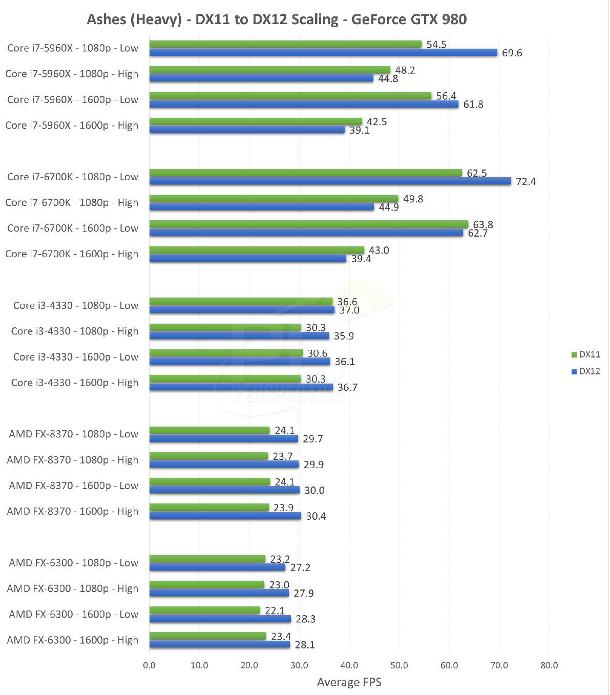

The 5960X isn't a great performer in Ashes, Skylake beats it:
Thankyou for making one of my points for me.:D
8/16 cores/threads v 4/8 cores/threads in DX12 should be an absolute non contest and just goes to highlight my point that AOTS game/bench is seriously flawed.
And what you are forgeting from the graph you posted is the 5960X is a pretty reasonable overclocker despite having 8/16 cores/threads. We don't all run our Haswell-E CPUs @stock like the people who produced that graph were.
Errm, DX11 is very poorly threaded and at best the 6700k has 20% higher clock speeds(3.5 vs 4.2), in reality from a very quick look at reviews I would expect the 5960x to not get as high out of it's turbo and the gap between stock/turbo is also much greater on the 5960x, even greater when you consider the clockspeeds 3Ghz to 3.5Ghz is just over 16%, 4 to 4.2Ghz is 5%.
So with a 20% minimum but maybe closer to 30% clock speed difference in DX11 the 6700K is all of 15% faster than the 5960x, under DX12 it's about 4%. With far great overclocks available(due to lower base clock) which is the 'faster' chip. If both clocked to 4.5Ghz, the 5960x would be spanking the 6700k in DX12 with ease.

Remember Skylake is faster in clock to clock aswell, it's newer arch with some nice improvements. And we are only talking about few fps here, in older version of benchmark. Remember there has been roughly 50% cpu performance uplift in game since that test came out.
There is not that much difference in per core performance between Haswell-E and Skylake but the 8/16 cores/threads of a 5960X will totally thrash the 4/8 of a 6700k in things like DX12.
Sadly AOTS is not a very good of how DX12 should perform.
